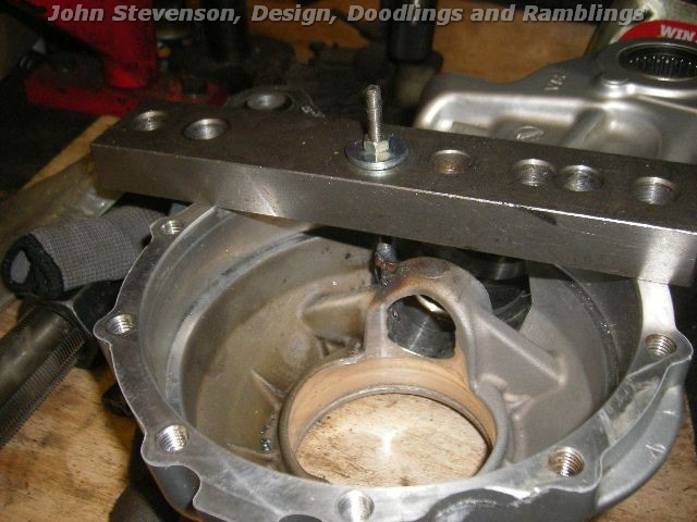

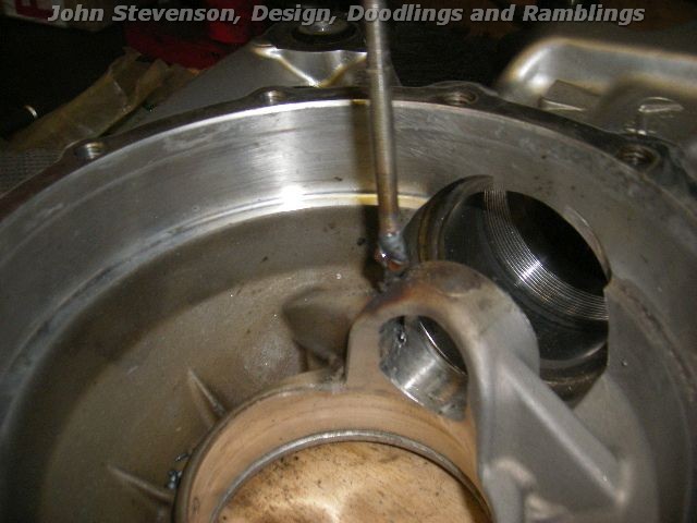

Interesting and relevant job today.
BMW motorcycle final drive housing. The last bearing is grooved and pressed into place and a roll pin located it from shuffling by going into the groove.
One problem, it's fitted into a blind hole, can't drill from the other side as that's the "pretty" side.

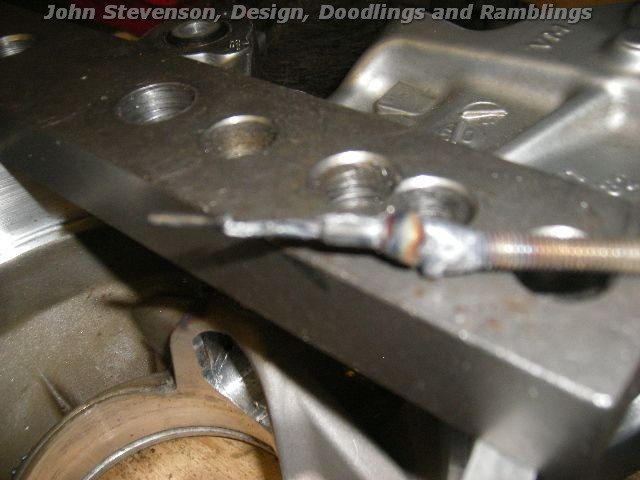

BMW in all fairness recognise it's a problem and fit a longer than standard pin that you can grip with a pair of mole grips fitted to a slide hammer. Problem is rolls pins squash up and are brittle so the bit sticking out just snaps off and you have the rag end of a roll pin just below the surface of a curved casting - lovely.
You can get the bearing out by just pulling it and wrecking the roll pin but it's still stuck in and now damaged.
Now it actually looks worse than it is as they spend a good hour piggling away at it and getting nowhere and loose heart. So 3mm roll pin - hardened - buried in an expensive alloy casting.
But you can weld steel with a Mig with steel wire but you can't weld alloy.
So dob a quick spot on the end of the pin, count three to let it cool, another dob etc. The idea is not to get it stinking hot so the alloy melts, sound easy and it is.
Once you have got a nice volcano sticking up weld a bit of studding onto this.
Fit a stretcher bar across, couple of washers etc.
Swift pull and jobs a good un.
Sorry it's a bit out of focus but you get the gist on how bad a state the pin is in after whacking the bearing out.
Job done and paint unmarked, another pie and a pint.

Posted by John Stevenson on 30/06/2015 01:32:28:. . . . . . .
Edited By John Stevenson on 30/06/2015 01:34:10
Significantly quicker than try to spark it out.

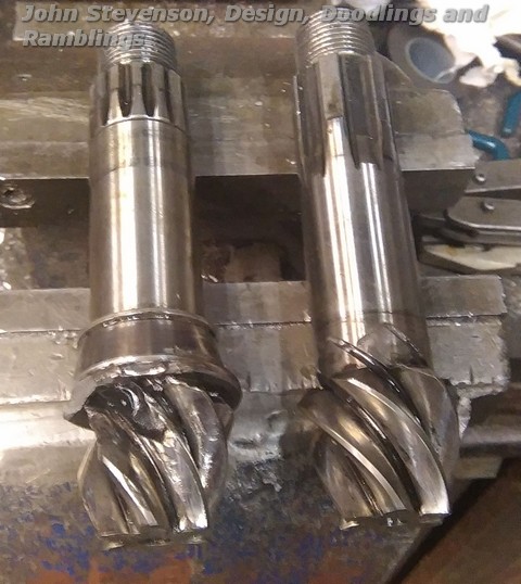

Started to put this one in the "What did you do today" thread but looked so pretty when it was done it deserves it's own shelf in the Lodge.
Started out with this.
The shaft on the right needs the same splines as the one on the left. It's off something to do with a fork truck transmission and no spares. Ideally it would pay to change the shaft and gear but the 6 spined gear is larger, narrower, and the offset of the dished gear is wrong.

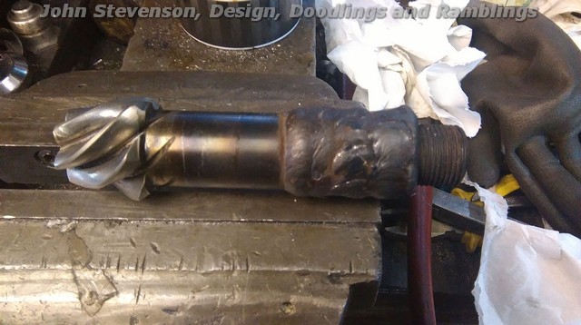

So first thing and this shaft is hardened is to remove some of the shaft and the 6 splines to get under the surface. So in the lathe and using resharpened carbide tips as they won't last long, rip big lumps off. No picture as it's straight forward.
Then build up with weld. The idea is to get the splined end hot so it becomes soft but not allow the pinion to become hot. So weld a bit and let it cool with the pinion under water.
This achieves two things, it keeps the pinion hard and also warms up last nights coffee.
Proof of which is in the photo below, no HAZ on the pinion, and the coffee was lovely.
Throw it back in the lathe and simple turning and we get a blank shaft.

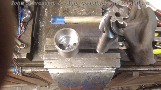

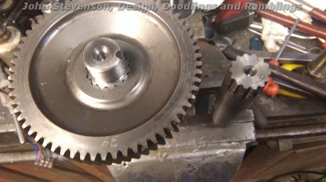

Next bit is hobbing the splines on the old converted Victoria U2 mill. As I only have one bit of the cherry or redo everything again I cut a dummy shaft and checked for fit. I fed the hob in the the text book depth and it came out a nice tap fit onto the gear.
However the hobber has an ER32 inbuilt collet chuck and no way will this pinion fit in so I made a tempory pot chuck with a 20mm spigot to fit the ER32, a ball bearing for a centre and two M5 grub screws as driver dogs to turn the pinion when in the machine.
So cut the spline, only a short one 18mm long and check for fit on the gear, dummy shaft to the right.
All done and dusted, just requires going over the road to the heat treat plant to have the splines induction hardened.

What weld wire did you use as filler?
Bob
John Stevenson25/08/2015 21:29:31
avatar
5068 forum posts
3 photos
Not sure of the ANSI ? number but it's very close to EN8 and allows the weld to be thru hardened.
On a big hardened shaft you can use ordinary MiG wire as there is enough carbon in the original shaft to leech thru and still get a hard surface, smaller shafts not so as many are not thru hardened anyway and you loose most of the case hardening turning undersize.
