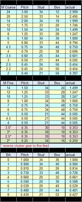

Hi Engineers,
Hopefully someone out there could tell me what driver gear and gearbox setting to use to enable me to cut a reasonably true 2.5 metric thread on my Imperial Myford S7B with gearbox.

Use a 33 gear instead of the 24 on the input gear then select 14 tpi on the box.
You can get virtually all metric threads on a gearbox equipped Myford without resorting to changing all the banjo over by using a 33 or 34 as input gear.

Thank you very much John, I suspected you would have the information at your finger tips, that is exactly the answer I needed.
The chart I have gives the input gear and the gearbox setting for a ton of Metric threads including 2 and 3 pitches but sadly not 2.5.

John's method is simply brilliant. A little work with a spreadsheet shows that you can get good approximations for all metric and BA pitches with very few extra gears.
I've got the metric banjo and gears for my Myford but I'll never use them again. Buy your 33 and 34 gears from John, he deserves the business for bringing this method to our notice (if not for his sense of humourwink)
Rod
