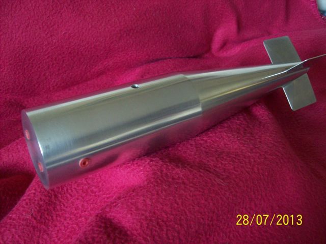

100_3568.jpg100_3566.jpg100_3564.jpg100_3563.jpg100_3562.jpg100_3557.jpg100_3556.jpg100_3555.jpg100_3553.jpg100_3544.jpg100_3540.jpg100_3535.jpg100_3527.jpg100_3526.jpg100_3522.jpg100_3517.jpg100_3514.jpg100_3513.jpg100_3511.jpg100_3510.jpg100_3509.jpg'Yellow Sun' is the name given to this bomb, and the model was requested to help illustrate talks on 'The Cold War'. It is made of light alloy throughout, to 1/24th scale, and is 2" diameter and 10 1/4" long. A dimensioned sketch was supplied, which I augmented by careful examination and perspective scaling of some photographs of bombs on their trolleys, adjacent to a Valiant and a Vulcan.
The simple body shape comprises two distinct sections: a parallel front end housed the warhead and supporting hardware, including significant electrical power supplies, whilst the rear is a stright taper carrying four stabilising fins.
The surprising flat nose was deliberately chosen to keep the dropping speed subsonic, in order that no shock waves would form and disturb the operation of the barostat triggers, set to a detonation altitude.
This model is of a later version with american designed warhead, using ram-air turbine generators to provide electrical power during descent. The earlier all-British design employed half a ton of lead acid accumulators which had to filled with electrolyte and charged before flight - hardly a viable rapid-response technology.
Dummy fin roots were fitted into fin slots whilst the body shape was turned, then discarded. A plug threaded into the tail end had a centre hole for in-lathe support, and was later shortened into the finishing truncated tailcone.100_3508.jpg

For some reason unknown to me, but perhaps obvious to others, the photographs appear in reverse order to that in which they were entered, and so give a step by step 'deconstruction' of the model. Just go to the end and work backwards. I'll do better next time. Thanks for looking.

I should have said that short explanations of each photo appear in my album Yellow Sun. they have not transferred with the photos to this thread.

Can I ask what the red plastic plugs are for?

Red plugs - ram air vents for the generators. Plug in  the side? Either air outlet or where they removed the ball bearings (see wikipedia).
