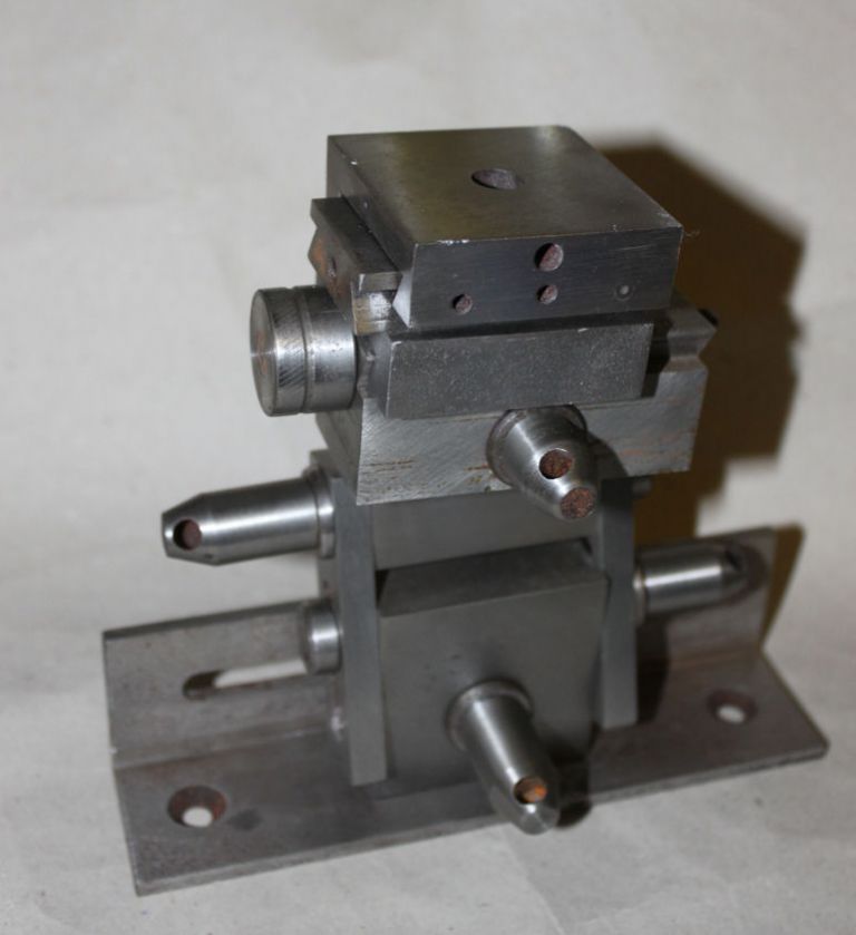

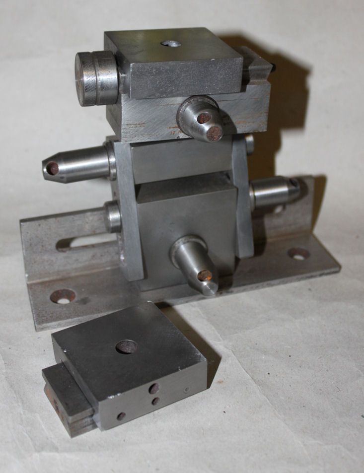

Hi Jonathan,
I have made Mr Halls grinding rest from his book WPS 35 "A Complete Milling Course". It is relatively easy and does not take too long to complete with basic tools. Which means that you get to grind your lathe tools etc more quickly. I have not yet made the attachments from the book such as the slitting saw or milling cutter ones, but I will.
I too used a cheap offhand grinder from a DIY store and modified as Mr Hall suggests, also shown in the book. I used the standard clamping strip, not the thinner ones, and have had no difficulty. It only seems to be a problem if you are not accurate enough with the milling of the blocks.  When I attach it to it's new base I intend to make a second angle iron support to attach at right angles so that I can move the rest to the side of the cup wheel ( I hope that makes sense)
Unfortunately Mine was damaged by fire but I managed to rescue it and am at the moment in the process of refurbishing it. I do think that it is worth making, You could build one of the more capable ones at a later date when you have sharp tools wink 2. Here's a couple of pictures - you can click them to enlarge if you wish:
As Made.
Grinding rest
Rescued from fire crook:
Fire damage
Best regards and let us know your decision and results. Many people seek advice here, we offer it but all too often we don't get to see the outcomes, not a lot to ask for all the thought, time and effort which goes into posting the advice
Terry

Posted by Stub Mandrel on 09/10/2012 21:11:33:
Terry,
I have discovered that the great volume of rust compared to original metal can make things look far worse than they really are. I work with a couple of guys who collect old axes etc. and a virtually shapeless lump of rust can appear just well used after derusting.
Out of curiosity, have you tried any of the various de-rusting approaches on that poor beast? If so, what has it come out like?
Hi Neil,
I also recognise that iron oxide occupies a much larger volume than steel. I am an eternal optimist and always beleive in the best outcome. I couldn't bring myself to throw away a lot of hard work so have strived to save what I can and have been quite successful.

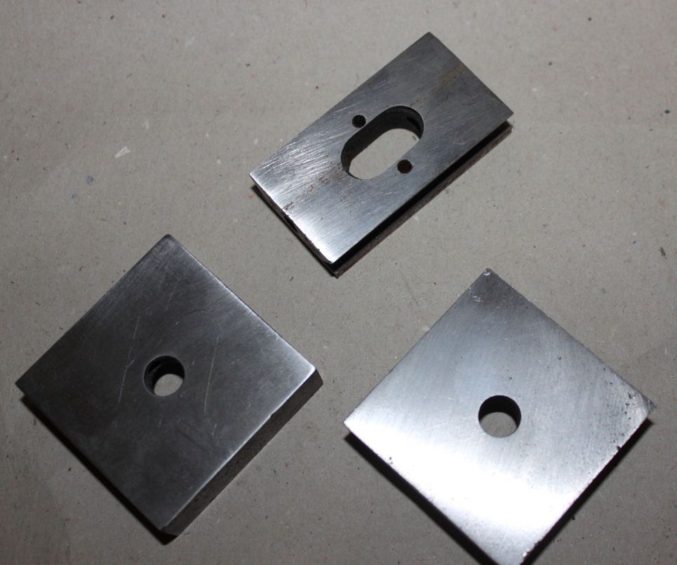

Here are a couple of extra pictures of the work in progress on the grinding rest. Actually I'm lucky that my time in the toolroom taught me how to grind tools freehand so the resat is not essential, but I would like to get the grinding rest operational for fun.
To remove the rust I initially used a hydrochloric acid bath to remove the deposits followed by a dip in hot washing soda solution to neutralise the acid and prevent further rusting. I scrubbed each component with a washing up bruch (plastic an dnylon) between stages.  Following that I dipped all components in an anti rust solution and put them into sealed plastic bags or boxes to protect them until I could offer my full concentration to restoration - and I still have a lot to do - I actually do the restoration on a 'need to' basis.  I should point out that i do this outside so as not to get acid fumes in the workshop with the inevitable corrosion which follows.
I hope the pictures below inspire others to not discard or overlook those apparently useless rusty items in the backe of the garage or at car boot sales, they can have a new life for very little cost and effort. Apparently, elbow grease is free!  Click the pictures for a larger view if interested.
Needs operating levers and upper work tables. Note how well the thicker side clamp arms fit. In fact the arms will support the upper block as a sliding fit before fitting the locking screw - no need for the thinner arms of Mr Hall's mods in this case..
Mock up of assembly, just need to clean up gib strips and table
I decided not to remove all of the rust pits, they remind me of the tragedy and also hold lubricant (dry ptfe)
