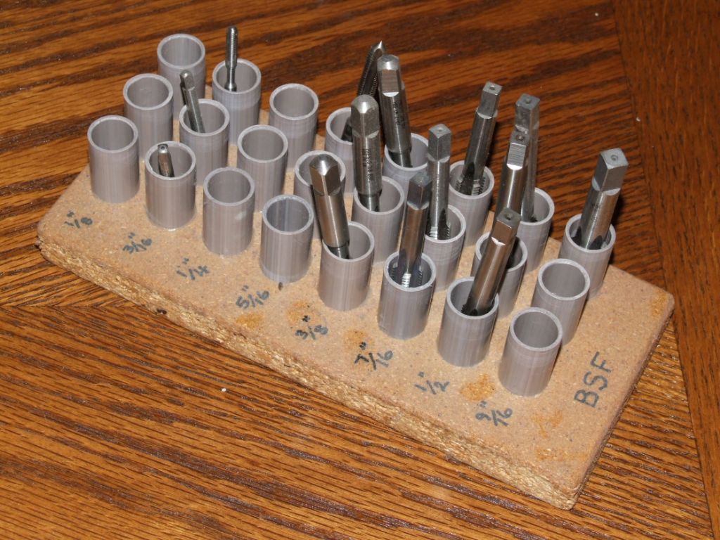

| would welcome any suggestions for a methodical and cheap method of storing taps, dies mills etc
At present all my end mills and slot drills just go into a box. Taps and dies are kept in individual poly bags and then different types eg. ME, metric, BA etc, then go into a larger poly bag. All the bags are were originally labelled with felt tip but this soon wears off.
The result is that I seem to waste hours searching for the right item.
There must be a better way!
Peter

I store my taps, milling cutters and reamers in blocks of wood with appropriate holes drilled in them.
Don't use oak, apparently it reacts with the metal.
I'll put some pics on later if you are interested.
Roy.
wheeltapper26/01/2012 16:11:37
avatar
424 forum posts
98 photos
LIke this
the wood is given a good wipe over with oil before use.
Dies are normally kept in dedicated holders hanging on the wall.
Hope this gives you some ideas.
Roy

I use RAACO wall mounted cabinets - drawers labeled with "Dymo" tape
For screwing kit - one drawer per thread size containing tap(s) & die. For some commonly used sizes also tapping drill ( and clearance too if you can be sure not to use this in error when tapping!) . Just remove drawer from cabinet and carry to job then return all on completion.
Counterbores together in one drawer.
Small end mills/ slot drills again 1 drawer per size.
Larger milling cutters, boring tools such as Roy shows, go in those little storage trays, available from Machine DRO, in the drawer of a Bisley cabinet ( bought very cheaply at the local tip!)
Centre drills, countersinks and reamers - I use Roy's method of the wooden block and they live on a shelf near the drill press.
I may be a bit fussy but I also have RAACO cabinet drawers for each size of fastening I use frequently. Hence if I want (say) a 6BA nut bolt and washer they will all be in one drawer and again I just take this to the job . Folk may say I'm fussy but I used to keep this stuff all together in a box and it took me ages to find anything. It did take me a while to sort out but now I can put my hand on the thing I want straight away.

I made some wooden blocks just like those shown above, which I shuffled around on a shelf for ages. My blocks hold a range of taps, eg BSF, together with the right tapping drill. It is easy to grab the right tap together with the right drill, with no rootling around. When I needed a particular tap, it was always in the last block I found. Then I made a wooden ply turntable supported off the wall, and located by the drill, and attached the blocks to the turntable together with drill stands with number, letter, imperial and metric drill stands. Now whatever I need is a short spin of the turntable away. It is amazing how much valuable time this simple device has saved, and it took an hour or two to make. I am just sorry I did not think of it 40 years ago.
Chris Gunn
PS I also did a similar thing with my morse taper drills, using an old pulley as a base, a wooden turntable about 9" diameter, and all the drills arranged in a spiral.

I use plastic tubes that the domestic engineer donates to me on a regular basis, these normally contain vitamin C tablets or multi vitamins. They are around 20mm diameter and can be cut down to accomodate various materiels.
I mount these in scrap boards of MDF, pine or whatever comes to hand. With a small quantity of light oil or paraffin they provide a rust free storage environment for many small components including taps, milling cutters, drill bits etc.

many years ago, I 'picked up' and old office KARDEX filing system. These were postcard sized cards which were used for addresses, work progress etc, and were stored flat in a nest of drawers which are about 3/4 inch deep x 24inch long and 7 inch wide. Sling away all the cards and their suspension system and you have a set of super storage drawers - perhaps keep 1 drawer to use for the progress of your model build. With a few wooden divisions, I store taps, dies, drills, reamers, silver solder, marking out tools etc etc. Each can have its own drawer. Perhaps look on flea bay
Speedy Builder527/01/2012 08:57:00
2878 forum posts
248 photos
This is what my KARDEX system for tap storage looks like, chewing gum tins are good for tiny taps - bottom drawer is a set of chasers.

Here's my solution:
Taps
Dies
The boxes were scrap timber which we used to be able to purchase for 50p a sack from my employer. The tap box had contained a Mercer surface gauge and , I think, the die box was for storing glass photographic plates. The tap box contains pretty much all of my collection: BSW, BSF, ME (26,32,40), BA and metric coarse. I don't have many taps above 1/2" (12mm). The base is 1" tropical ply and there is some minor evidence of rusting on some shanks, presumably from the tannic acid in the timber. When I made the base 20 years ago I put a drop of oil into each hole. Perhaps I should repeat this. The dies are in solid mahogany and do not seem to have attacked the dies but they are in less close contact.
