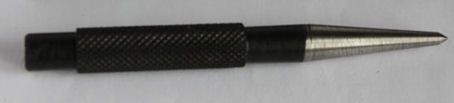

Clean new motor oil will work just as well as the 'old' stuff without the nasty toxins. I have done some very good blacking by that method. The 'old engine oil' needed is just an old wives tale (or should that be an 'old engineers' tale)  We used to use new whale oil in the 1960s, but that's quite rightly frowned upon now.
Here's one I did earlier (before tempering):
You just don't get much blacker!  It only works on steel though
