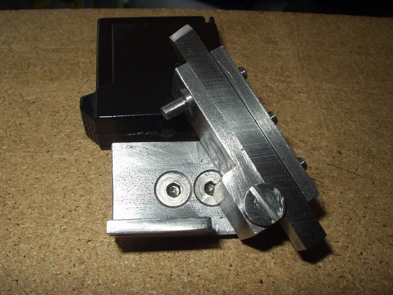

I had a go at making this gadget.
I've been reading about them over on the Madmodder site and thought they looked interesting .
I altered the fixing bar to an angled end one so it fits into my qctp to avoid excess overhang.
in the last pic you will see my mistake, I only had 4mm angle ,not 5mm, but I still milled 5mm off the base of the toolholder so I made the locating stud with a collar to adjust it.
It really works a treat too. It's quite fascinating to watch it glide back to the start.

It's one of those things that makes you wonder why no one else has thought of this in the last 100 or so years ?
I know we have had quick retract etc but the flip up as controlled by the rotation of the machine is so simple.
I built mine from the original article in Madmodder about 6 months ago and it's been in use since then, virtually daily as I do a lot of screwcutting.
Mine is a lot different from the article in fact I use a completer tool [ ex-parting tool ] as the swing element
The red tool is my original tool and the holder on the quick change block is one that hold one piece out of a coventry die set.
Ideal for cutting metric on an imperial lathe as you never need to touch the half nuts, no chance of a miss match.
This has got to be one of the better things I have built, it has saved me endless amounts of time.

I think that JohnS should get some credit in the article, as well as Bogs, for he played a part in the development of this marvellous tool.
I too have been using one since they were first mentioned in the Madmodder site, but mine uses TC threading inserts. You just can't beat the proper geometry of commercial inserts, despite their considerable expense.
I also have a "clapper box" tool holder that takes "Ifanger" style HSS threading bits.
There are a couple of other photos in my album about Milled HSS cutter.
I know you lot are a conservative bunch but if you do any threading at all, make yourself one of these holders and find out the joy of quick and painless threading.

Bogstandard21/06/2011 06:58:28
263 forum posts
When I was developing this tool from the idea by Mike Cox, I made the fatal mistake (for me) of making it as a standalone unit that dropped onto my QCTP. I later showed sketches of a much easier to make unit that fitted into the holders by means of a bar on the back.
This is of important relevance. On my one, I can't lift it up completely so that I can check for fit, I have to run the tool a long way past the end before I can check by screwing a nut on.
Another point that I raised in my article was that people were leaving off the front side to side stop ( the basic idea that John S came up with) and just putting a big washer on the swing stud, hoping that will take the side loads, it won't, and actually puts a lot of extra stress onto the pivot point, which if people are not careful, could easily break with no warning.
I will let you know now, and even all the diehards should take notice. I have been single point threading for most probably nearly 45 years, and this is the fastest and easiest method I have yet come across, and another point, you put the feed on for the next cut as the tool is working it's way back to the beginning, so no time wasted there.
For all those that don't have a lathe that stops fast, all you need to do is to measure how far the cutting tip travels when you turn off, and press the stop tit that far from the runout slot, it might take a couple of goes to get it just right, but once you have that info, you too can enjoy trouble free, no brainer single point threading.
I have tried it with no topslide offset and with the offset, and personally, I find the offset method less of a strain on the tool tip, and again IMHO gives a better finish.
You can't knock it until you have tried it yourself.
One day I must make myself one of the easier ones, then, for me, it will be even easier.
