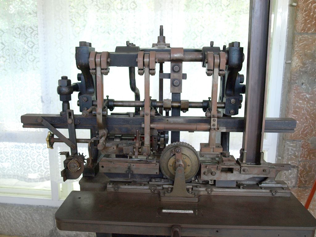

Richard,
When I was out on your plains in 2008 I took some interesting pics but have no info on the details.
The Loco picture you may be able to identify, if not I have some more images. If you look carefully you can just see the missus peeping out of the first carriage window.
The second is a poser for your or anybody else that takes a look.
It's a machine found in a station waiting room, not operational, that's obvious.
It may have been on the kiddies railway but I can't guarantee that.
It just look a tremendous piece on engineering, god knows how old it is and what it is.
It will be interesting to see what ME browsers come up with.
P.S.There's no prize for getting it right but then I wouldn't know if it was right!!
Len P.

Hi there Len. I think you were on a special excursion train on the MÁV operated narrow gauge line (760mm) from Kecskemet to Kiskörös. Normally these are hauled by a Raba 48 diesel. The Spark arrester is of a new type. I cannot see its wheel arrangements. If she is a 0-6-0 then I saw her in Kecskemét yards and believe she is a ‘Budapest class’. According to Paul Engelbert the Raba 48 is a derivation of the MÁV Raba 24 standard gauge shunter. It has what they called a ‘Hydraulic Drive’.  What this means is it has a ‘fluid flywheel’ in place of the normal clutch. The Raba 48 would make a good 5” model.
If you look here you can relive the journey (choose the Narrow gauge Kiskörös item). Towards the end of this you will see a ‘rail car’ (literally a car with railway wheels on it) and somewhere else in the yards there is the remains of a drasine’ which had an air cooled motorcycle engine. There was a forest railway somewhere in the North which held ‘Open Days’ in January where you could bring and drive your own drasine, but I cannot now find the web site. January in Hungary is not a good month for outdoor activity!
There is a very good book by Paul Engelbert called ‘Forestry Railways In Hungary’ if you are interested. Most of the surviving tracks are used for ‘Tourists’. The best is that from Miskolc up to Lillafüred and beyond.
There is still the Children’s Railway in Budapest. I think they now have some beautiful rail cars which were used to take passengers from Miskolc to the Palota Hotel at Lillafüred.  A very up-market joint which has lost its way.
By the way I think the curious machine is a ticket printer. I have seen something similar in the Museum of Transport in Budapest.

Steve Garnett10/12/2010 08:58:25
837 forum posts
27 photos
Posted by Richard Parsons on 10/12/2010 07:38:43:
I think it is too. I did a bit of checking, and it's just possible that this is a very old Goebl machine, of which there are supposed to be very few examples. Just in case anybody was wondering, I think you put the blank tickets in the stacker on the right, and they pass through to the left. I presume that there's some sort of power source underneath - can't see how it can be driven otherwise.
Bet you needed quite a solid floor to mount it on! (just to keep this OT)
