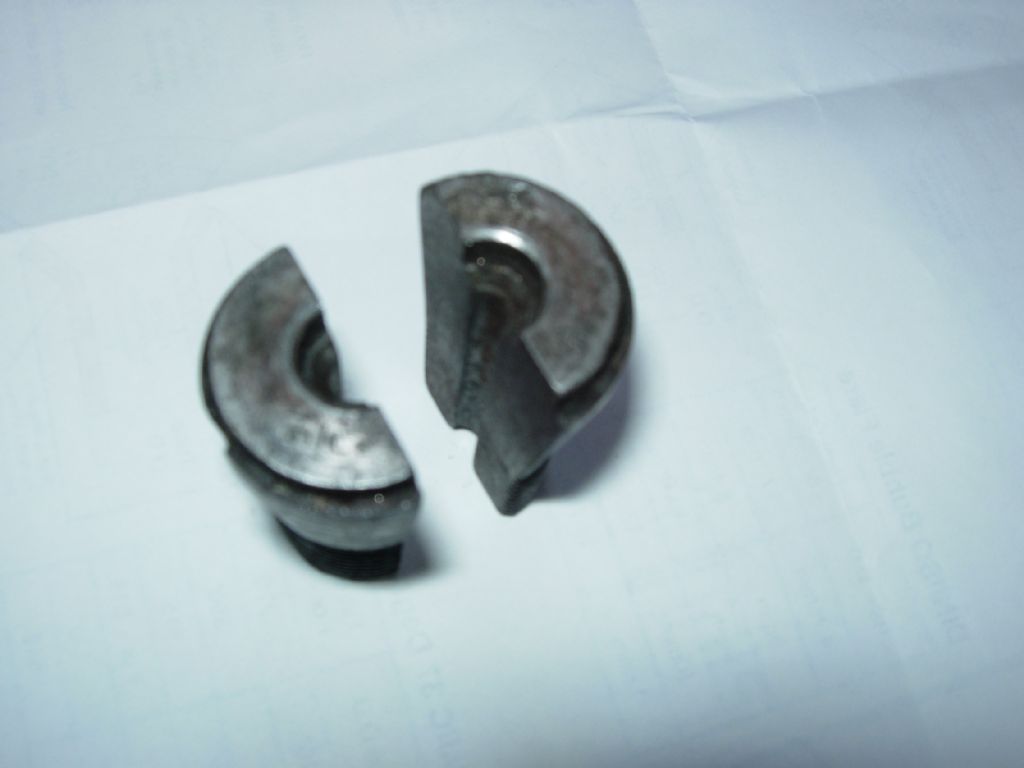

Thread: 2 piece collet ?
26/05/2011 08:07:52
hi guys
thank you for all the tips/ information. this time i will buy some second hand collets but now i know what to do next time the situation arises
many thanks
james

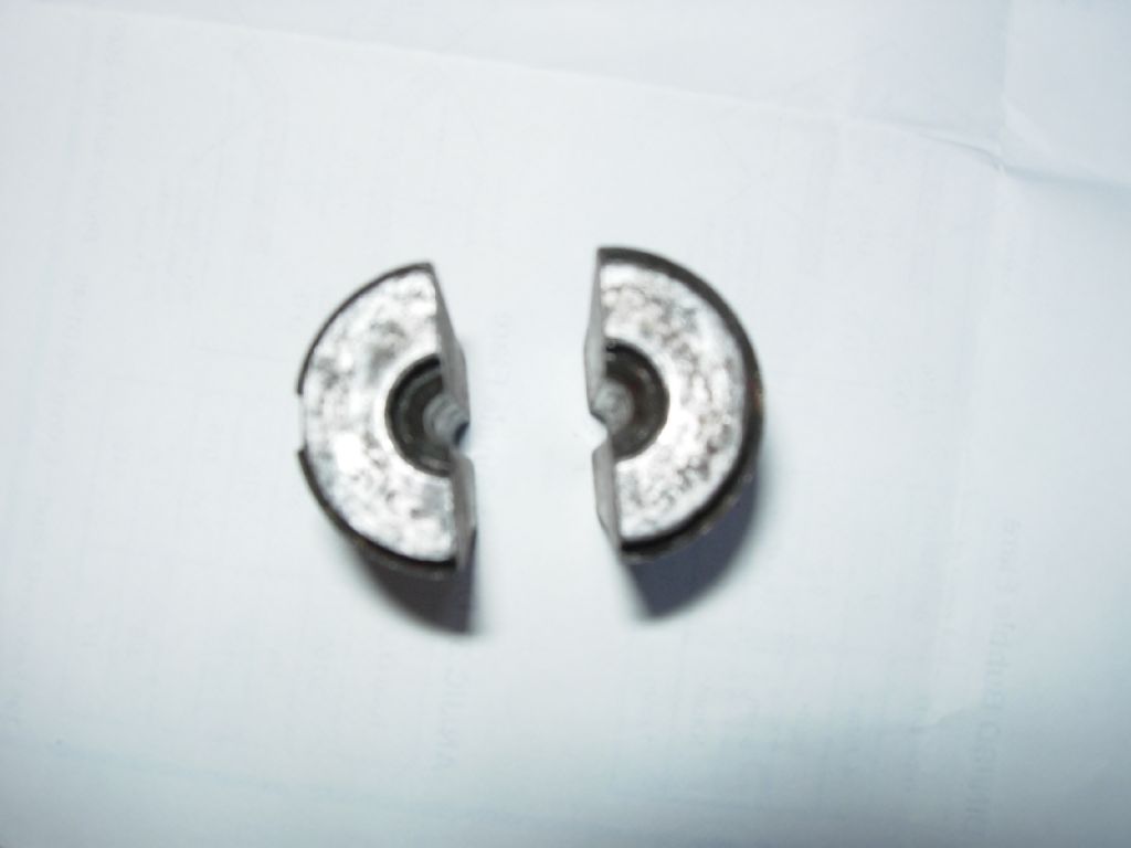

24/05/2011 22:19:08
thank you pat, i could do with a small gap but not much, as if the collet grips the entire circumference of the pipe then it cant compress it much, i have though about different types of collet but it needs to be able to split as the flared end is obviously bigger, i just fear that if it has a gap and its not circular then it will deform the pipe and then the flare wont be circular for operation 2 to be carried out ( doubling over the flare or bubbling it )
many thanks
james

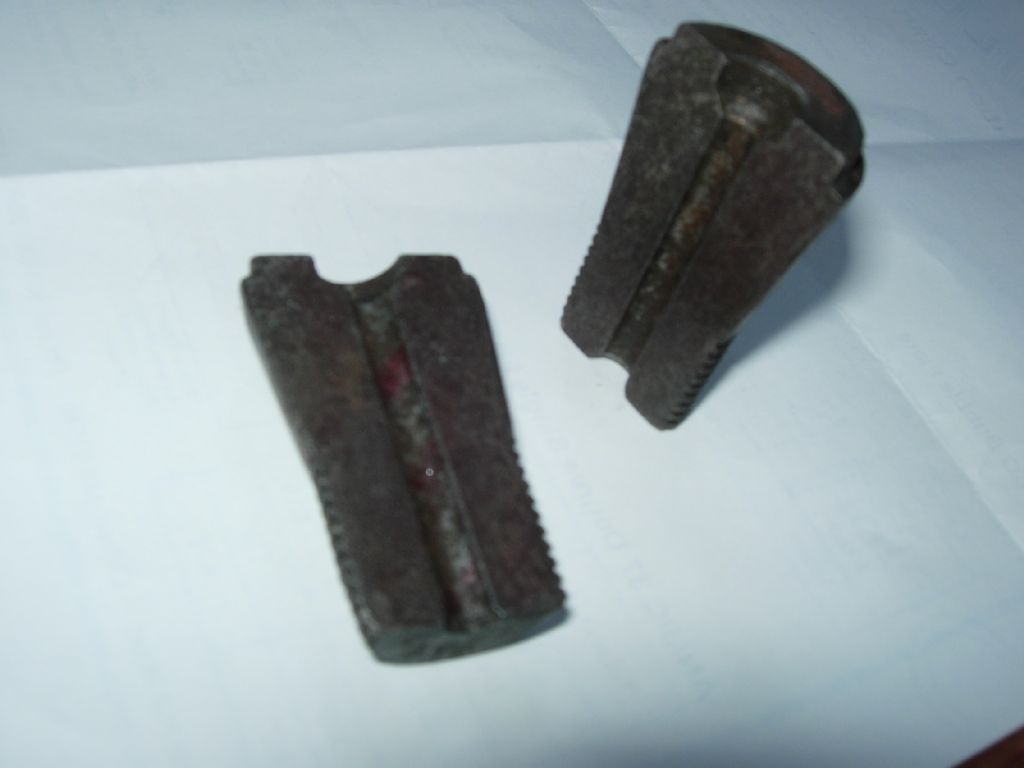

24/05/2011 22:06:45
hi derek it is a sykes pickavant brake flaring tool, an old one.
the reason i need to make some new collets is because the spanner that fits over them is worn and the thread on the collet is also damaged, i thought if i machined some with standard metric threads it will be easier to replace next time.
many thanks
james
24/05/2011 22:03:06
thanks for the suggestion Les, i don't have a 4 jaw but its about time i bought one
tony, i have a 7x14 mini lathe and a warco minor mill, if i split it after wards when it is clamped up into the taper the inside diameter will not be circular it will be elliptical, ideally it needs to be circular as it is a toll for gripping brake pipes for flanging.
many thanks
james
24/05/2011 21:17:01
hi every one
i need to make 2 more of these strange 2 piece collets and would be grate full of any advice. i think i could cut some bar dow the middle and super glue the 2 halves together so i can still keep it symmetrical, cutting after the machining is not an option.
any help would be welcome .
many thanks
james
