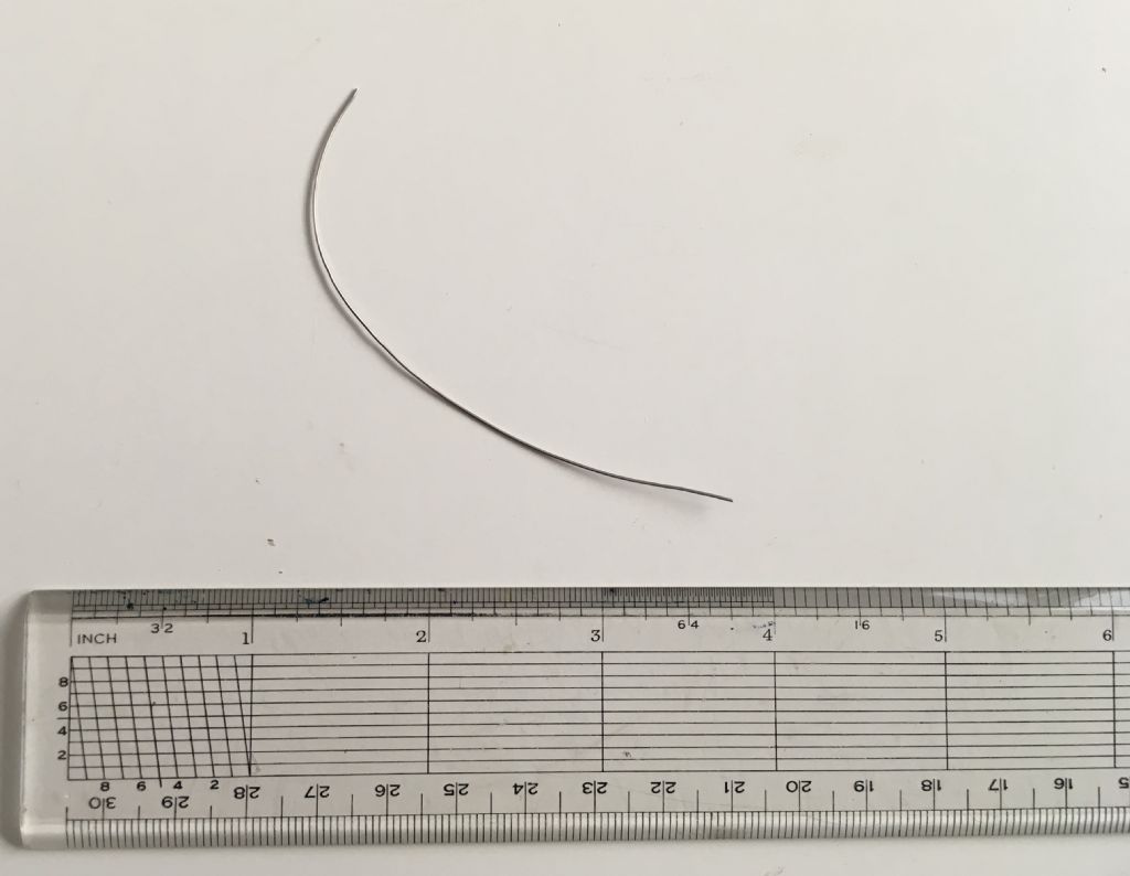

So … I have been on the lookout for Platinum wire, and recently purchased this piece:
It was described as 99.99% pure Platinum with approximate dimensions of 0.5mm diameter and 100mm length, and an approximate weight of 0.4g
For no particular reason I felt, and still feel, confident that the Seller was honest.
When it arrived, however, I decided to just check that the numbers tallied
The density of pure Platinum is quoted as 21.45 g/cc and therefore my piece should weigh around 0.42g
The Mitutoyo digital calliper suggested some variation between 0.49 and 0.51 diameter,but the wire will never be straight enough for it to be worth using the micrometer.
The length was simply checked against the plastic rule and is near-enough 100mm [it has been cut with nippers, and seeking better accuracy is probably futile]
I then weighed it on my good, but uncalibrated, scale at 0.40g
… which is also happens to be what the seller’s photo of his weighing showed.
All of this together suggests that the material is basically Platinum, but it goes nowhere near proving that it is 99.99% pure.
Using the nominal dimensions the weight is about 5% too low.
The questions that I invite you to ponder are:
What is the overall Uncertainty of Measurement in what I have done ?
and
Given that there is no traceable certification of purity for this piece, is there any affordable way of checking it more accurately.
Please note: I don’t expect any numerical answer to the first question, it is essentially rhetorical. …I just want you to think about the way we put trust in the numbers our instruments display, with little but blind faith.

I think there are two uncertainties in this problem: uncertainty of mass and uncertainty of volume.
It would also be worth verifying the quoted density from a number of sources.
The volume is also a 'composite' number, calculated from a diameter and length.
It might help to think of the uncertainties in each of the sub-elements and see how they might contribute to the overall number.
Since the diameter is squared to find the cross-sectional area, the error in its measurement is also squared.
It is unlikely you would be 5% out on measuring the 100mm length.
If the scales are underweighing and the volume is overmeasured, the two errors conspire together to produce a lower density.
Do a very quick calculation to see how much the nipped ends might reduce the volume.
Is there a practical method to measure it in a different way, perhaps using Archimedes method with distilled water?
What impurities are likely in platinum? Do all likely impurities have densities less than platinum?
Finally, we have had numerous definitions of the inch on this forum in the past. On the same lines, are you using the correct value for pi?

I suspect, but cannot currently demonstrate, that the weighing is the biggest contributor to the error [if error it is] … the machine consistently reads 0.40g for repeated weighings, but its ‘minimum division’ is specified as 20mg
Take that, along with the fact that it is uncalibrated, and it seems to be the prime suspect.
It is difficult to visualise either the diameter or length measurement contributing a 5% error, but of course the final answer involves all of them.
For your comfort I would add that most [not all] metals are less dense than Platinum, but in the quantities required to reduce the weight by 5% the wire would surely not perform as Platinum.

What you have not told us is the resolution and accuracy of your measuring instruments. If the scale only reads to 0.01g that is a resolution of +_1% on 1gram or +_2.5% on tour 0.4g measurement. And that is just the +_1 count error of ANY digital instrument (quantisation error). You have to add the accuracy of the sale on top of that.
Likewise your digital caliper has a resolution variance of 2%.. As it is squared that is a +_ 4% variance on area. You have to add accurcy on top of that. A micrometer would be a better instrument for this measurement.
Your instruments are not up to the task. As a rule of thumb you need ten times the resolution / accuracy of the measurement you want. I doubt your measurements are within 10%.

I agree with Robert, you're at the limit of what you can measure with retail equipment. There are 4 measurements, so even 1% per measurement will get you a total of 4%. Getting it right to within 5% is pretty decent.
Andy_G22/07/2023 22:10:00
avatar
260 forum posts
There is 8% uncertainty in cross sectional area from the diameter measurements...
Can you check density using the Archimedes principle? (Weight in air vs weight in water) You would probably need access to a 4DP balance - N.B. don't assume that the density of water is 1g/cm^3 - it isn't when trying to work to these accuracies.
Anyway, on a separate note, Pure Pt *is* wetted by molten glasses. There is a specific, non-wetting alloy that is Pt5%Au.
