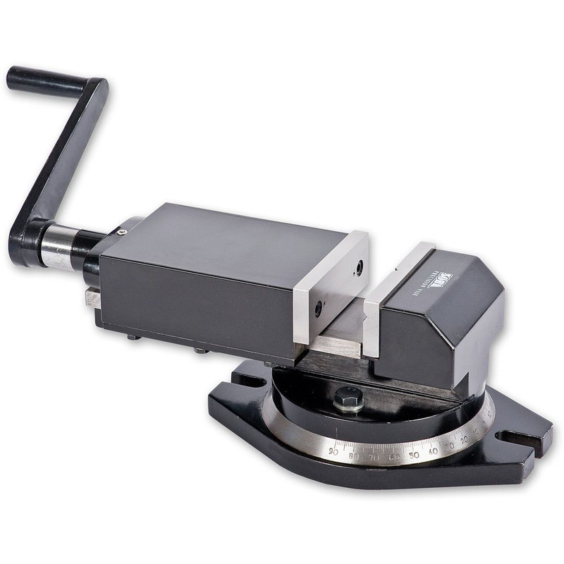

Has anyone come up with a reliable way to fit a machine vice to a mill so its always square/parrallel

I use a dial test indicator on the back of the fixed jaw aiming for 0.01mm across the jaw width. Although all three of my mills have nominal 5/8" slots in practice they are all slightly different widths so I don't use tenons. Another issue with tenons is that they can get damaged, or damage the table.

The one with the rotary base needs the base removing, there should be a groove underneath the vice with two tapped holes.
With a lever indicator mounted in the spindle check the rear of table tee slots run parallel when you move the table.
If they do turn the vice upside down and grip the tee slot with the jaws and do the same indicator check on the groove. If parallel great, if not make it so with a milling cutter.
Make 2 tenons to fit the vice groove exactly and also table tee slots with a little clearance.
When you now mount the vice in the tees the rear fixed jaw should indicate parallel when tapped toward the back of the table.

SillyOldDuffer12/03/2023 10:51:24
10668 forum posts
2415 photos
A set-square is gets close, but isn't good enough on my mill because the vice sides aren't finished accurately square to the fixed jaw. It's an inexpensive vice!
People have fitted pegs underneath to align with the T slots. This works reasonably well, but the accuracy depends on how well the pegs are placed, how accurately the slot is cut, and there's no wear and tear.
So I use a DTI held in the spindle to square the fixed jaw.
  1. The vice is set approximately with a set-square and the bolts gently nipped down
  2. The table is moved until the DTI arm is positioned at one end of the jaw, with about a mm movement beyond resting zero. Then the dial is zeroed, and the forward/back slide locked.
  3. The table is moved right/left so the DTI is reading the other end of the jaw
  4. The difference, if any, is noted. If zero, tighten the bolts and check in case doing so accidentally misaligned the vice
  5. If not zero, tap the vice gently with a hammer so that it swivels on the bolts enough to halve the DTI reading.
  6. Repeat from step 4 until the DTI doesn't detect any difference, or the difference is small enough not to matter.
This setting accuracy achieved by this method is high, and it depends mainly on the accuracy of the fixed jaw and the DTI (as a comparator). Chief dangers are accidentally turning the spindle, which is unlikely, and jambing against rather than swivelling round the bolts. First attempt likely to be painfully slow, but becomes surprisingly quick after several practice sessions.

I didn’t want to start cutting or drilling my vice so I made a couple of stepped sleeves that are an interference fit on my vice mounting holes and a snug fit in the tee slots. Simply placed on the table with the sleeves in the T slots and it’s within about one thou. If I’m really picky I clock it as well but it doesn’t take long. Luckily the design of my vice - two accurately bored mounting holes, rather than slots allowed this.
Edit: This is the type I have but it was supplied without the swivelling base.

My mill vice came with a rotating base but I don't use it and milled key slots and fitted keys to locate in the table slots and use a vice/chuck on a rotary table for milling at an angle.
Always push the vice keys against one side of the table slots while clamping which will eliminate any miss-alignment in a sloppy fit. The keys are accurate enough for 99% of jobs. Always dial in for accurate cuts.

If you are still using this vice take off the swivel and go looking for the two metal keys and screws that came with it when bought, Uncle Ketan has kindly cut the slots and tapped the holes for you. I use them on my 80mm version on the CNC and like Andrew just clock the back jaw of my K4 on the manual mill.

Cheers guys some great ideas. As Jason very kindly pointed out i have that vise and will use the slots.
