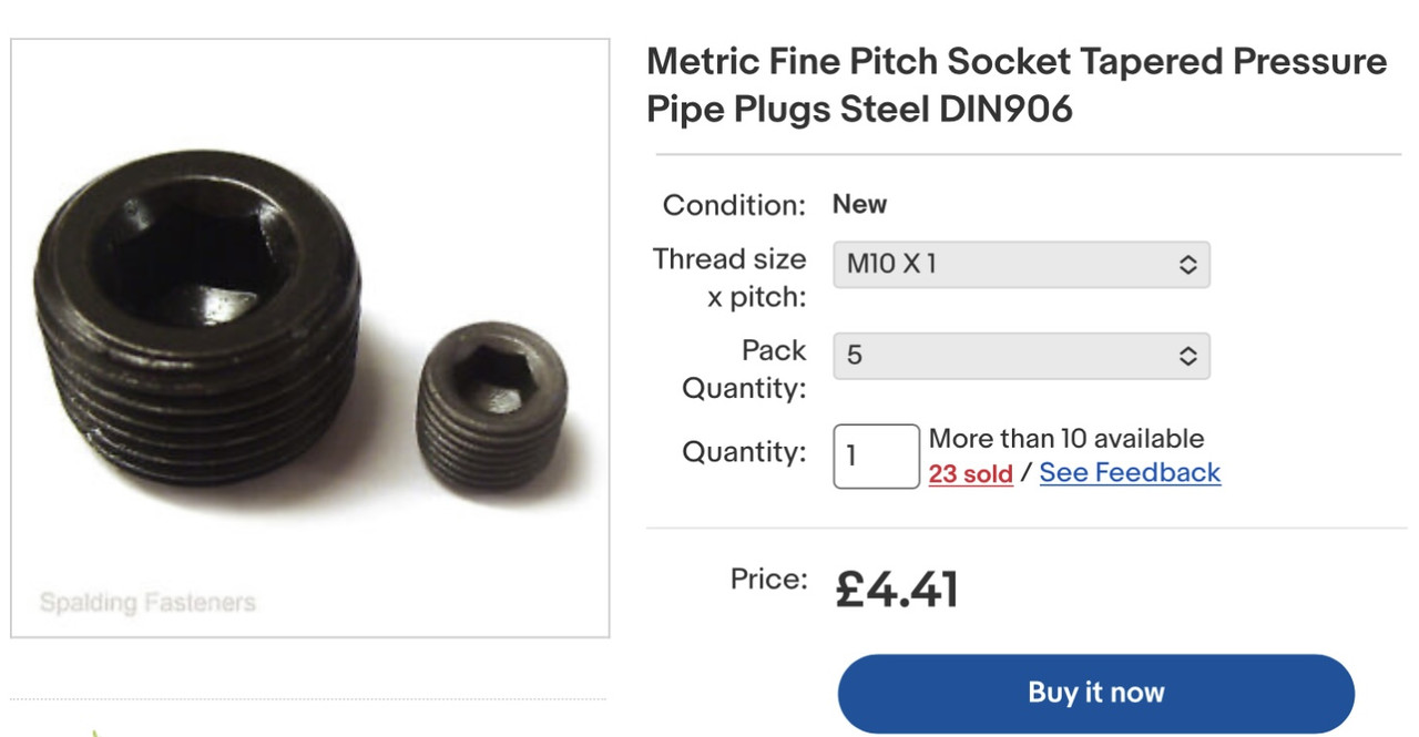

I have a small project planned that requires a spring to be retained by an M10 “threaded object”. cheeky I discovered some time ago how much nicer and easier it is to produce fine threads in M10 and M12 so I hoped to use M10 x1.0. I normally get my fasteners on the auction site but I’ve found it very difficult to get anything in that size and pitch except for bolts which are far too long or shipped from China.
I then happened upon these. I’m hoping they do the job and lock in place nicely without thread lock etc. Not so expensive that I can’t put it down to experience if they don’t work as intended. I didn’t realise that M10 x 1.0 fasteners were so rare, I’ll have to buy an M10 x 1.25 tap I suppose for future projects. wink

That offer is for taper thread plugs. Is that what you are after? I would have thought that a spring retainer would need a parallel thread.

I have only come across M10 x 1 (and M8 x 1) for hydraulic fittings, hence the tapered pipe plugs you show a listing for. IIRC the last M10x1 pipe plugs I ordered were for blanking an outlet on a VW Type 2 master cylinder. M8x1 is a standard size used on lubrication fittings for central lube system restrictors.

Posted by John Hinkley on 01/01/2023 11:23:48:
Vic,
Yes I know, as I mentioned no big deal if it doesn’t work out.

Would THESE do from Zoro?
https://www.zoro.co.uk/shop/fasteners/screw-plugs/m10x1-00-mf-skt-plug-screw-din908/p/ZT1086461X
It's worth searching for M10 extra fine, rather than just fine.
See also Taper
https://www.zoro.co.uk/shop/fasteners/screw-plugs/m10x1-00-mf-skt-pipe-plug-din906/p/ZT1086418X
And Straight Stainless
https://www.zoro.co.uk/shop/fasteners/screw-plugs/m10x1-00-mf-skt-pipe-plug-din906-a2/p/ZT1086425X

Not hard to use a die or screwcut a bit of 10mm bar to M10 x 1, put a slot in the end or mill a square "head" and just screw that into your m10 x 1 hole.
1/8" BSP is a similar overall diameter easy to cut thread and plenty of plugs about in that thread size.
