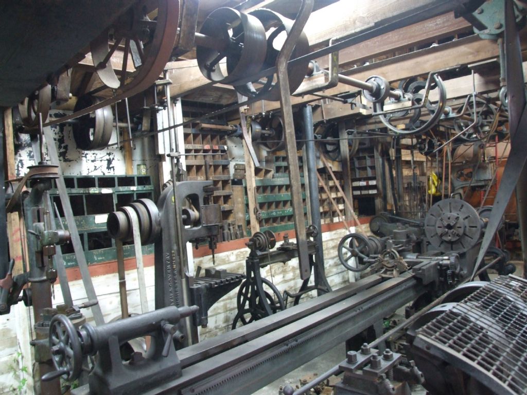

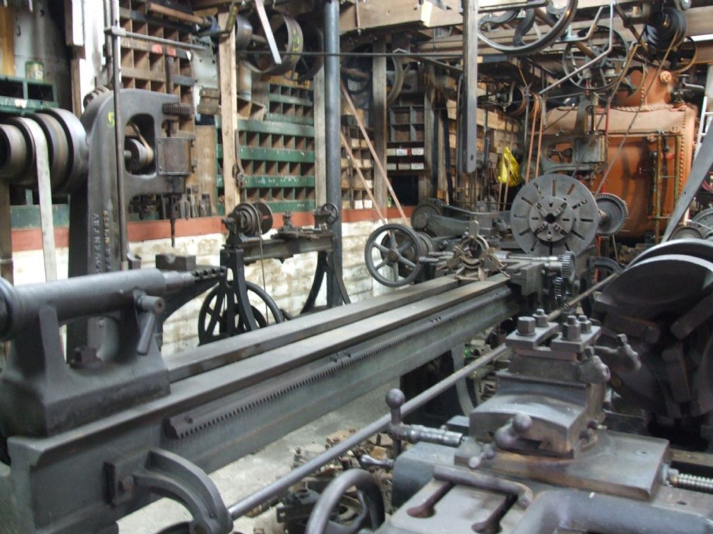

Thread: FORNCETT MACHINESHOP (line shafted )
02/10/2023 17:18:35
forncett 23 096.jpgFor those who wanted pictures - here they are ! Just 2 ! the rest are in an album.forncett 23 094.jpg
