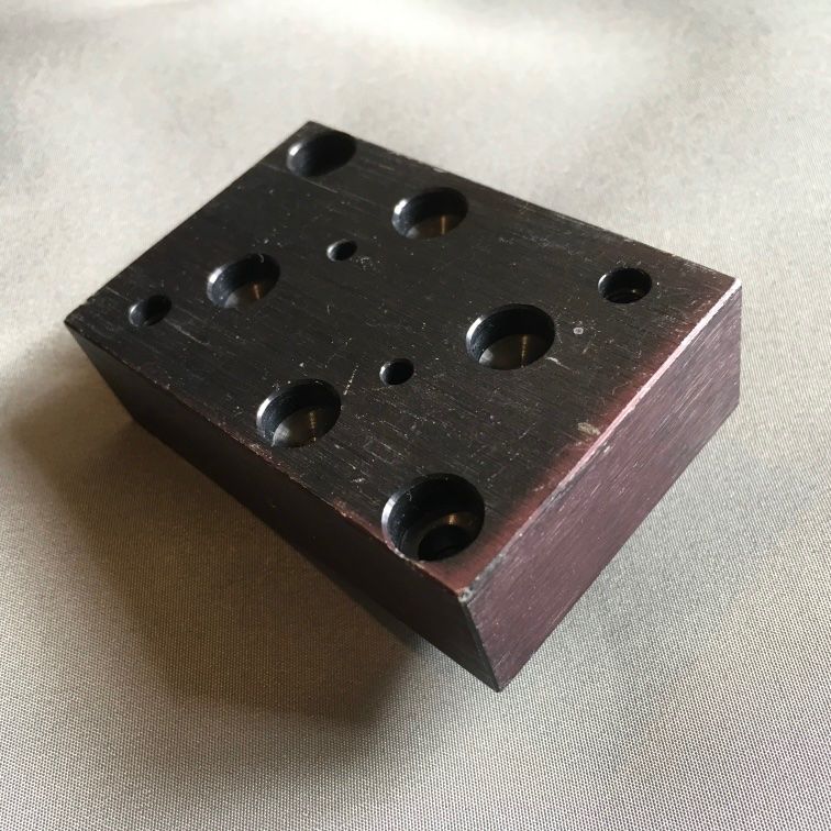

Be wary of ‘unsophisticated’ black anodising … it tends to fade to purple with prolonged exposure to light, and also on contact with soluble cutting oil. crying 2
Obviously, these characteristics will vary with the specific materials.

Gettin a good black can be tricky. I use commercial anodising dye in a heated bath (55°C). The dye is available in small quantities on eBay for £10 to £15. It produces a good, deep black that has proved colour-fast.
If the dye is leaching out (as per the example above) it would imply that the sealing stage hasn't been successful (the process is Clean -> De-oxidise -> Anodise -> Dye -> Seal ) - sealing by immersing the part in boiling tap water for 20 minutes has worked for me.

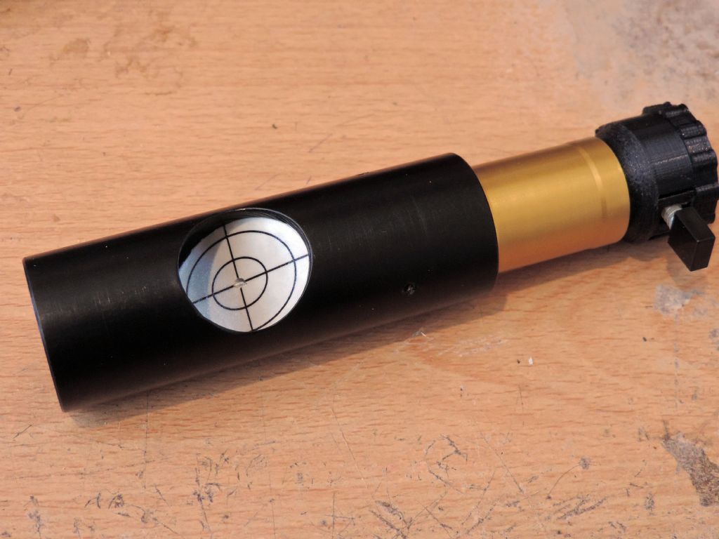

I'd agree with Tim, except the finish with inkjet inks should be waterproof, assuming you seal the anodising by boiling or with proprietary sealer.
I anodised this laser collimator with gold and black dies from Gateros Plating.
