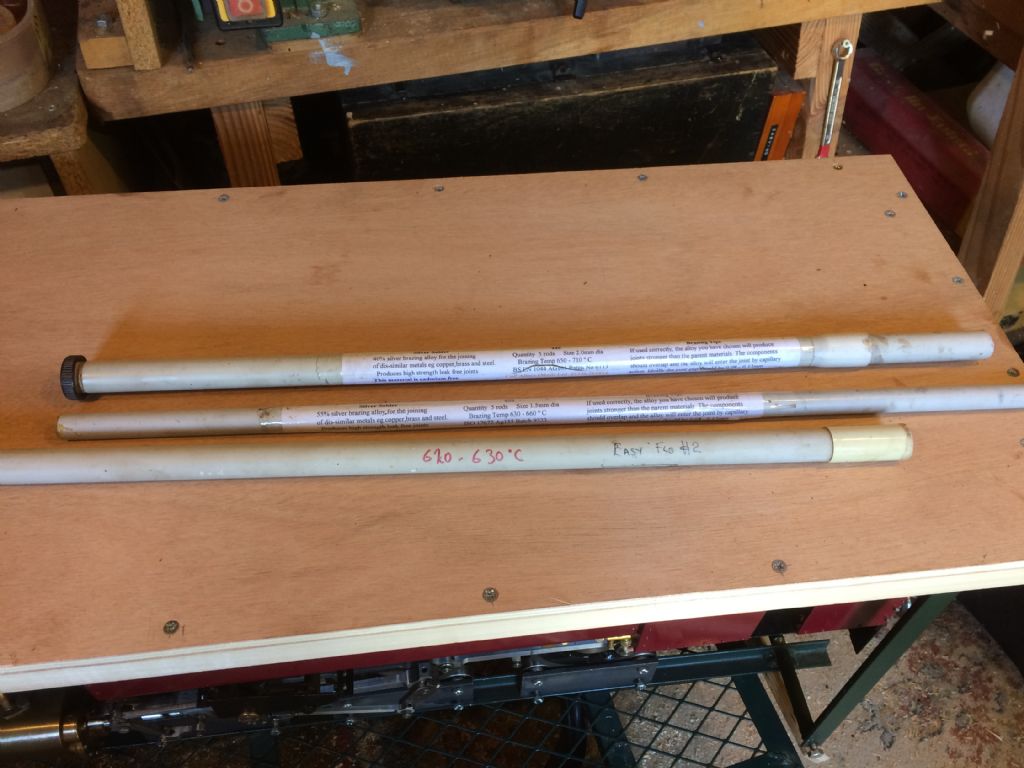

Circlip15/06/2022 09:01:08
1723 forum posts
Is there some direct link between Fibre optic cables and the Silver Steel storage tubes heading this thread?
Regards Ian.
Mike Poole15/06/2022 10:45:01
avatar
3676 forum posts
82 photos
The picture belongs to Speedy Builder’s thread on silver solder storage, a pictorial typo I think.
