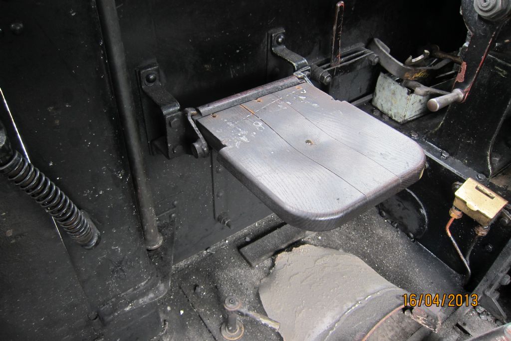

Here is one for the rivet counters. I would like to be able to fit a couple of tip-up driver/fireman's seats to a 5" gauge loco from oak measuring typically 15" square by 0.1" thick but the problem is that in order to make it look somewhat less slab like I would like to be able to create the bum shaped depression in the centre of the seat. Does anyone have any ideas on just how this might be achieved in 5" gauge? The attached photo shows an example of a full size driver's seat taken at one of our preserved railways.

Carve it out with a gouge or some form of disc/drum sander. I assume it's 1.5" square not 15"
It's an odd shaped bum depression as most people have two buttocks, I wonder if the metal one shown has just become dented over tine by being used as a step

The traditional tool is a travisher. You can get them in various sizes but I shouldn't think that small - assuming it's a scale seat rather than one for a full-size driver.
Could you use Miliput or suchlike putty with a thumb-pressed depression?

It does seem strange that a seat would have one central depression as in the picture as many wooden seats have a U shape depression. And I doubt if standing on a wooden seat would dent it like metal Jason.
Maybe designed like that so they would not want to sit for long. To recreate this a simple dremel type drum sander will aid in making it because of the scale of it but don't forget the bolt in the middlelaugh.
Or even a carving Scorp

Jason, on my screen, the seat shows woodgrain and looks to me like three pieces. To make a replica, I would use a dremel size flap wheel.

Sorry, I can see the grain now I have enlarged it, silvery colour made me think it was metal.

I'd establish first if the full-size seat for the particular loco or its related classes, had such hollows. (I am not convinced by whatever happened to the one in the photo). However, assuming so, by comparison with other furniture generally the mouldings would be so shallow that very careful sanding, perhaps assisted first with a rasp, ought be sufficient to represent them.
I've never had cause to measure furniture to that detail but generally, situpon hollows don't look much more than about 1/4 " or so deep.

A nice sharp bullnose end mill ought to do the job

The depression isn't very deep. Some 80 and 120, possibly 180, grit paper glues to stick will make that quite quickly and keep the non engineered shape. The seat of pants over a few years will make this or standing on it with hob nails. Windsor chair makes have special tools but on this scale they are not needed. Look for a finer grain. Oak can be distinctly coa
rse and not in keeping. Should it have an oil and coal dust patina?

angle grinder fitted with sanding disc. Test correct depth of the scallops by putting marking blue on buttocks and sand away the high spots (on the seat, not on the butt....).

These are bigger than the scale you need … but the video shows seat shaping:
**LINK**
https://youtu.be/sJIhJ33l4sQ
Edit: __ Here is his tool for the full-size chair seats

I suppose a bum shaped grinding wheel would generate a bum shape
A foam backed roll of sandpaper?

I think that sometimes we overlook the obvious solution and that is put it in the lathe and turn it with hand chiselsas a woodturner would do this.
