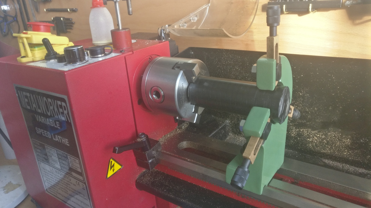

This is my first workpiece that requires a steady. I'm not sure how to align the steady so that the workpiece sits staight. YouTube proposes a couple of methods, one very long winded which requires specialist tools and another method using a dial guage attached to the chuck. The dial guage method isn't working for me due to lack of space on the mini lathe.
What methods are mini lathe owners on this site using?

I'd suggest a dial indicator with a magnetic base and stand. Mag base positioned on lathe bed top or front, indicator tip running on the end of the workpiece near centre front. adjust the steady's jaws until runout is near zero. That's it. The setup in your pic looks like there is lots of room for this method.

If the workpiece is running true and is circular then fit the steady to the bed as close as possible to the chuck, set the steady fingers to the job and lock off the bottom 2, slacken the top finger to allow the released steady to move along the bed closer to the end of the work then lock the steady to the bed and tighten the top finger to the work.

Like Emgee I will chuck the work and just turn the chuck by hand to make sure it eyeballs true then set the steady close to the chuck locking the two lower fingers. Loosen top finger and slid esteady to end of job then set top finger.
Can't see the point in using a DTI on the end as it could be indicating true but may be up down or sideways from the lathes axis and if so can start to walk out of the chuck when you start up. If you are going to use a DTI fit to carriage and run along side then top of the work to check it is parallel to lathe axis

For quick 'n' dirty work I use the 3-jaw chuck and adjust the fixed steady to align a mark on the end of the bar to a centre in the tailstock:
For more accurate work I use a short length of stock in the 4-jaw, centred with a DTI, and then used to set the steady. Then the steady is moved, the workpiece installed and the chuck end checked with the DTI, as with this 30" long bar:

But not just checking the rotation. You also need to check the alignment along the length, vertically and horizontally, to ensure that the steady is not bending the workpiece. Setting the steady up at the chuck end then moving it along the bed to the required position has always worked for me.
