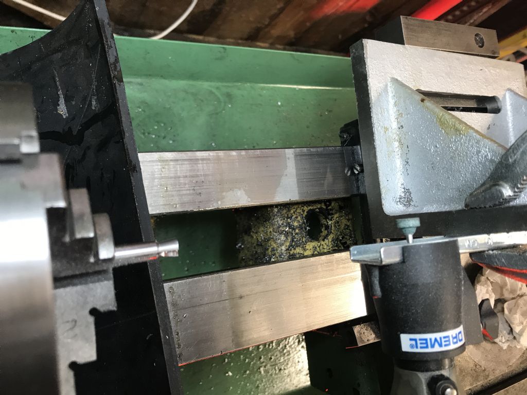

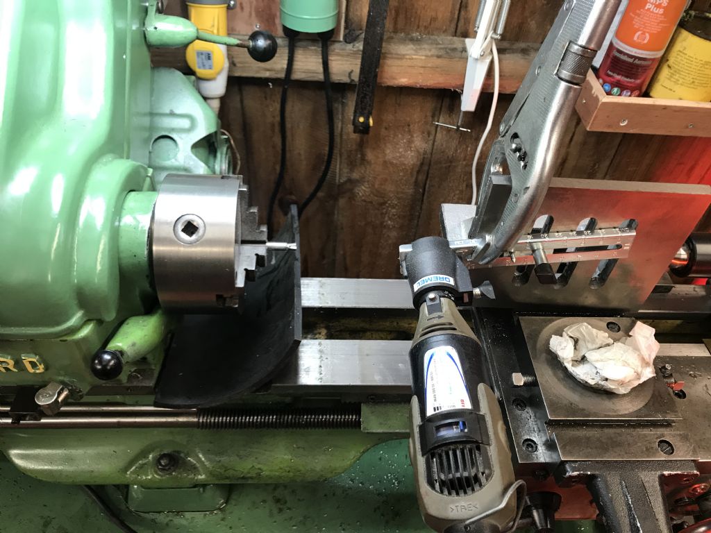

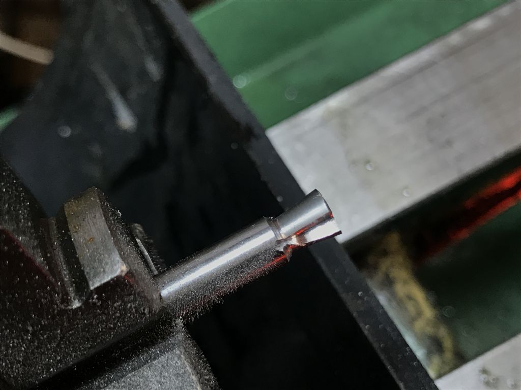

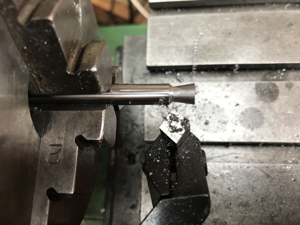

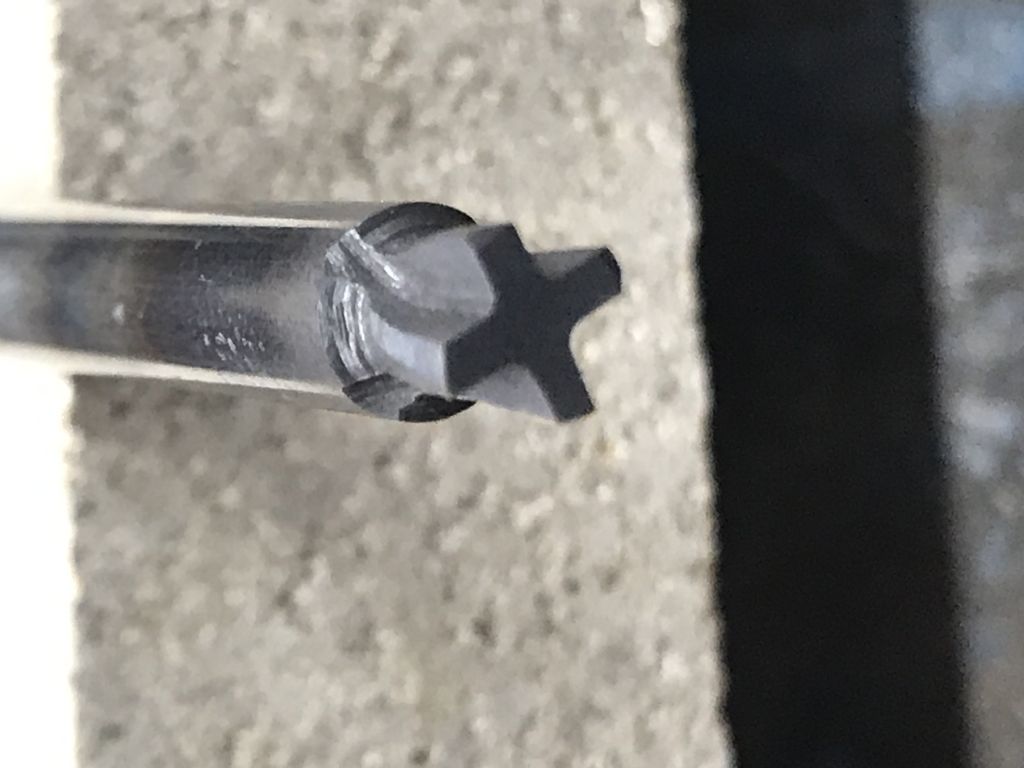

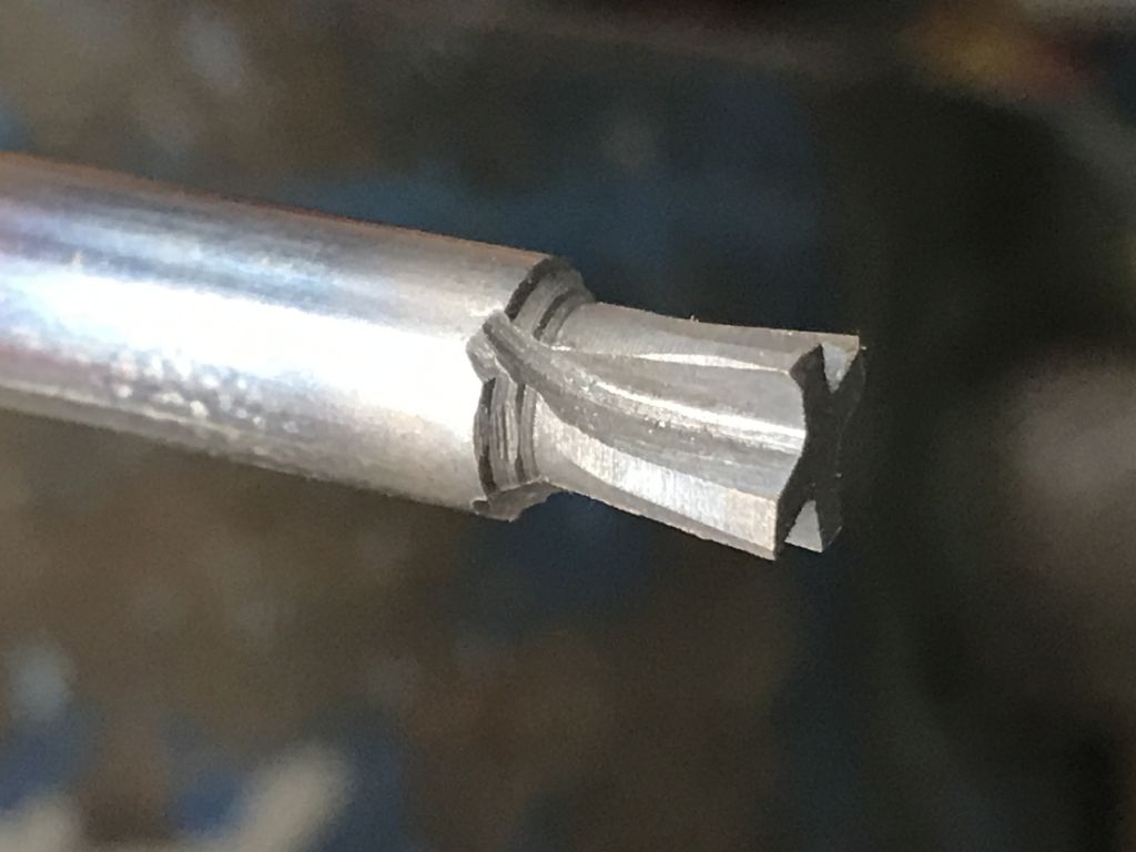

Thanks to all the encouragement & pointers from the collective, I decided to "have a go", after all, the point of the exercise is to improve my skills & knowledge & hopefully produce something useful in the process. I worked with what I had & hopefully produced a workable result, time will tell.

Looking good. Before heat treating are you going to relieve the centre like John above has done?
