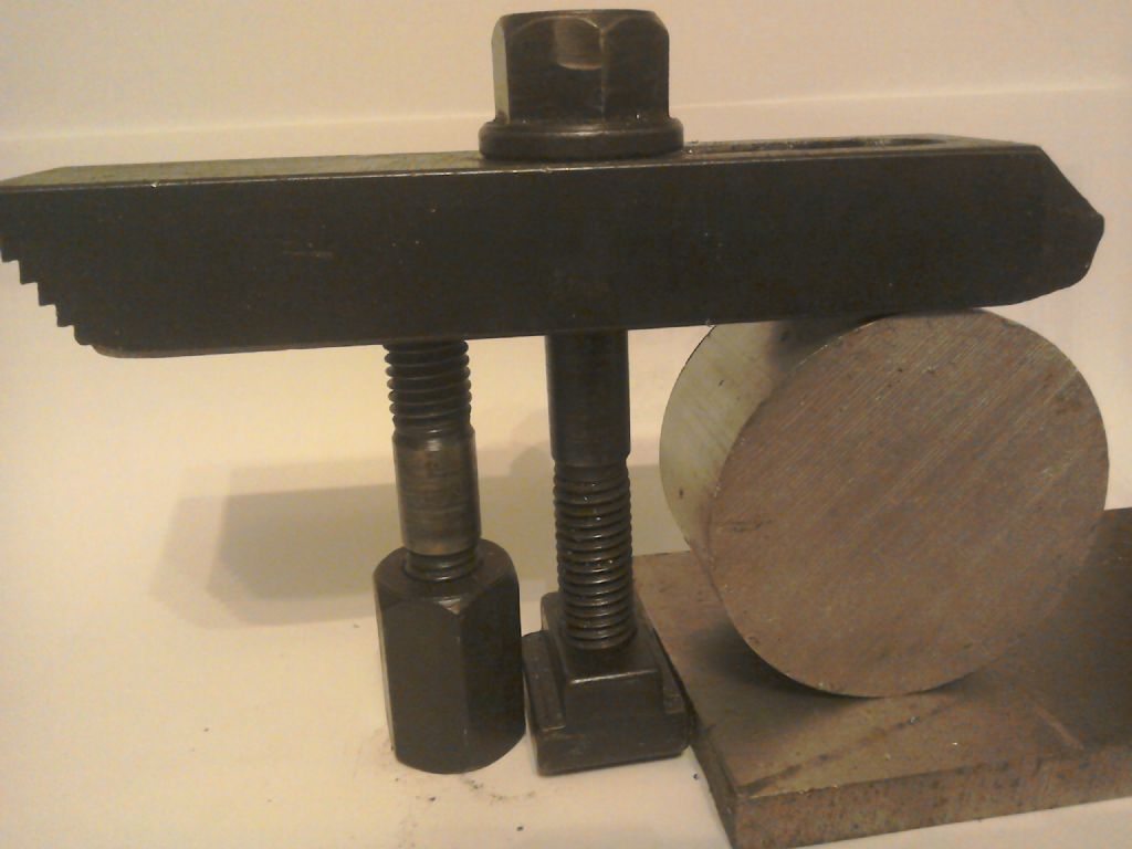

It the top stud goes up a little more or the bottom stud goes down a little more you have a loose setup. Never a good idea. Put a support on the opposite side of the studs to keep the clamps level so that there is no way for the studs to go loose. A simple machinists jack (see the one made by Dr_DMJN in this thread Stuart 10V Build Log for a simple design) will allow a good solid clamping action. Alternatively have a metal bar across the workpiece with holes for both the studs.

Rear support of the clamp bar using a clamping set hex coupler and stud as a simple jack. Keeping the clamp close to level is important to avoid side forces on the stud which will encourage it to go down the gradient and so loosen.

Martin -
I realise your photo is simply to illustrate the method but with respect I would -
- put a nut on the top end of the jacking stud to increase the bearing surface a bit, and avoid the risk of harming the end turn of the thread; and
- put the jack further back so the mechanical advantage is in favour of the jack holding the work-piece rather than vice-versa. (It's about 2:1 against in the picture.)
