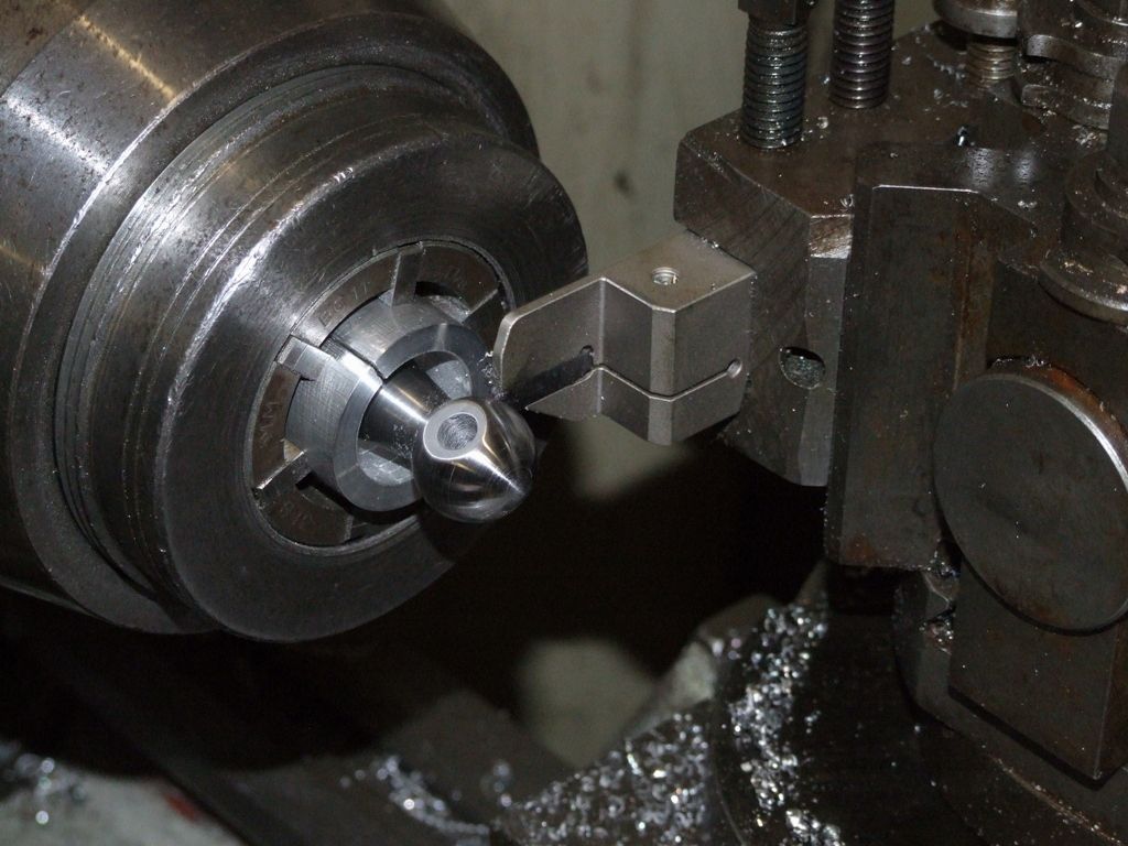

Because it's not a parting tool, but is intended for profiling and grooving. At least that's what I use mine for:
Dunno why he feels the need to part off so far from the chuck. Well I have an idea, but this is a public forum. smile
