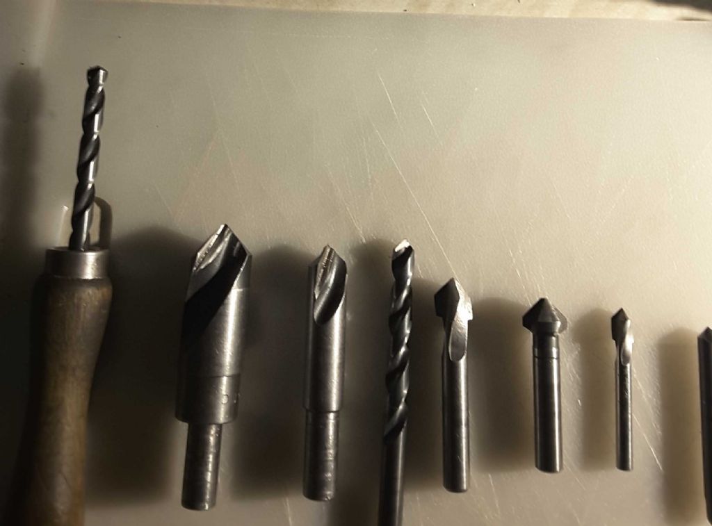

David George 129/04/2020 09:55:20
avatar
2110 forum posts
565 photos
In making special purpose machinery I had a selection of countersinks to suit the screw head as some were close together or an edge etc. We measured the diamiter if the head and got a drill a few thou bigger than the head and reground the angle of the head to suit the angle of the screw. UNC is different 82 deg. Then the cutting angle is flattened to almost zero to prevent chatter and grab. When you use one of these they all look the same even if you go a little deeper and looks professional. There is a slight flat on the edge of the head on most screws in engineering so make the hole to suit.
The fourth from the left is one I still have it was for 10 UNF
