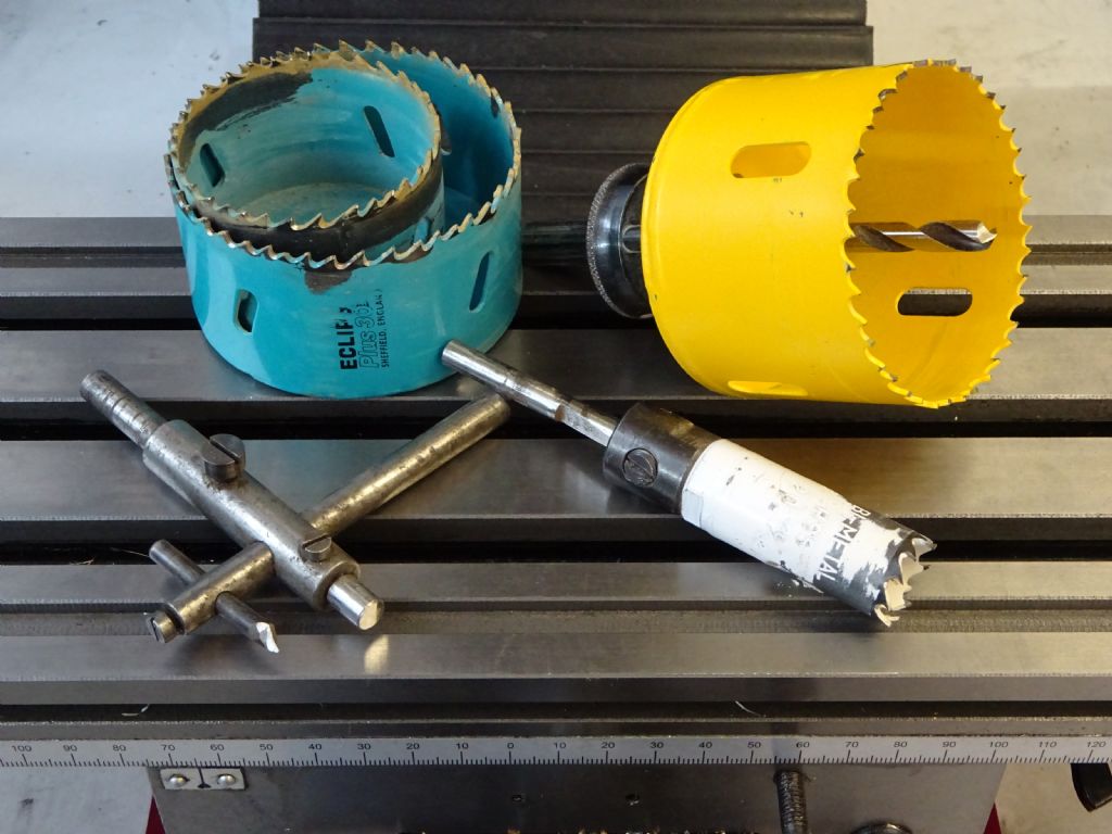

I need to cut a hole in some 2mm alloy sheets. Its for a computer as I want to add an extra 120mm fan.
I was just going to but a hole saw from screwfix **LINK**
Any advice ie should I sandwich between 2 pieces of wood

Have you got a boring head, could do it with that.

Posted by petro1head on 21/11/2018 18:29:53:
I would, then it should be easy.
Make sure it is well clamped, if it can move, it will.

Mark the centre, scribe the circle with dividers, drill, saw, chisel the centre away, file to the scribed line. Shouldn't take more than 10 minutes or so in aluminium.

The hole saw option will be a complete dogs breakfast. Hole saws tend not to be especially round and you will end up with an oversize/oval hole.
The way to do this is to use an abrafile in a fret or coping saw. Mark it out with dividers then drill a small hole to get the abrafile in. Then saw out your hole.
Minimum amount of filing then required to achieve the final dimension.
Abrafiles are now sold labeled up as 'rod saw blades' I believe.

The hole saw will cut a decent hole if used in a drill press and the plate clamped to a wood backing piece, I have done thousands over the years, usually freehand in a pistol drill.
The saw you link to will need an arbore to mount it though, a cost effective method would be the drill and file method.

You don't need a big head, just a tool out the side, this quick video was done for Ron in his boring head thread but I just used scraps of 2.5mm ali as an example.
Not a bad finish

How about a tank cutter, treppaning tool?

If you don't know what a treppaning tool looks like it's the one bottom left. That would do the job too.

The tool Jason refers to as a trepanning tool is probably what John and I call a tank cutter, originally used in an old fashioned brace, or very low speed power drill.

The tank cutter type tool works well until you break through, i find attacking from both sides is helpful but you will probably still need to tidy up with a file. Hole saws seem to make a hole but holding to a size is not their strong point. If you don’t mind a bit of filing then jig saw most of the waste and file to size.
