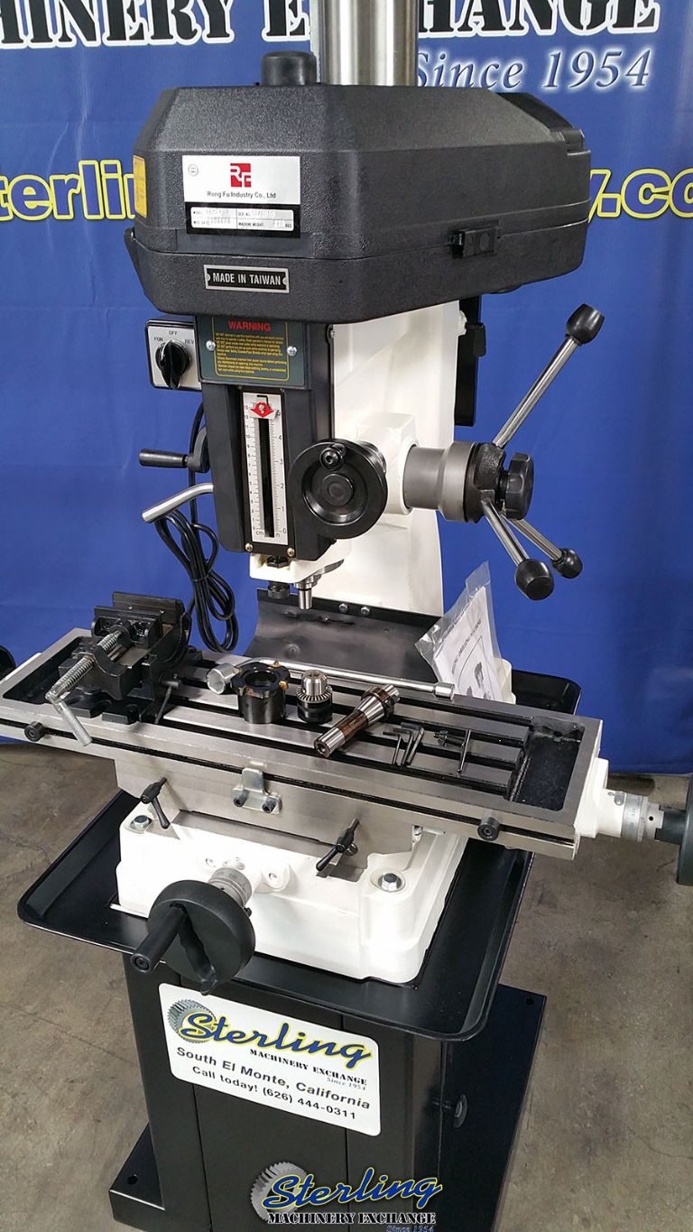

HI
I have just purchased a RF 31 BENCH MILL.
It is made by RONG FU Taiwan.
It is new, unused but "shop soiled"
I need a few additional parts for it.
It is well made, robust and heavy weight is 600lbs +
I have contacted the original supplier in USA, - -his name plate is on the machine.
He says he has no european contacts and cannot help..
I appreciate all advice thank you
RAY

Well as the photo shows the OP already has an R8 chuck (the adaptor is fitted in the spindle) and an R8 shell end mill, I'd just get a generic R8-MT3 adaptor to allowMT3 tooling to be used as well.
I suspect this is exactly what the "3 MT DRIVE SLEEVE" is.
The photo also shows a quill clamp lever fitted, so is possibly a "generic" photo of the particular machine & not the OP's own.
