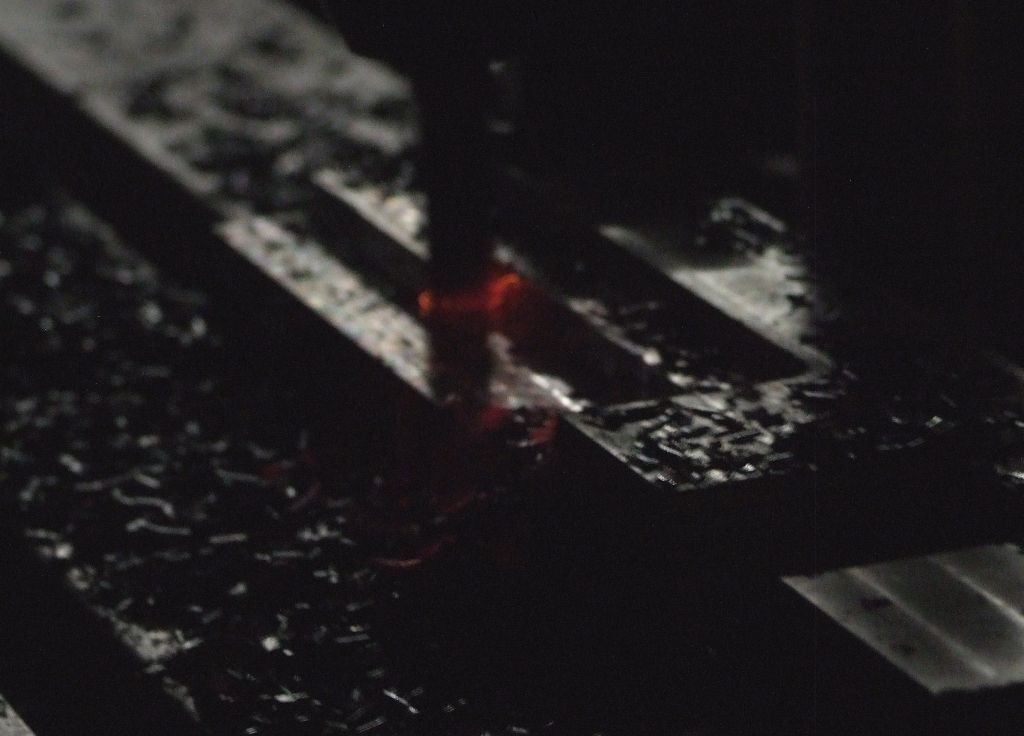

This is what you get when you push hard; cutter glowing dull red and the swarf is bright red:
Old, and blunt, Garr 10mm uncoated 3-flute carbide cutter at 2000rpm, DOC 5mm, WOC 8mm and hand feed about 300mm/min. Material is hot rolled steel. In daylight the swarf on the table is dark blue/purple and smoking.
The cut was in the climb milling direction, relatively easy to wind the handle. Whereas with the same parameters conventional milling I could barely move the handle. Hooray for climb milling!
Before anybody says, yes I know it's a Bridgeport, but it's old and only has a 1.5hp motor, so equivalent to many mid size hobby mills.
So which one are you? smile
Andrew

Is there a benefit from having a cutter glowing?
Alan

Yes, when speed matters more than cutter life. The heat softens the metal, making it even easier to remove quickly, a dubious advantage in my genteel cowardly workshop.
There's an economic trade-off between cutter life and metal removal rate. Time is money. I'm a hobbyist who prefers to maximise the working life of my equipment. Production is a different game and they tend to drive machines and cutters close to maximum, optimising power consumption, finish, & removal rate rather than cutter life. They're much more prepared to wear out cutters in short order when it pays to do so.
Running red hot destroys HSS - it can't take the heat.
I'm not aware of any research into optimum amateur removal rates. I reckon I'm over-cautious. Couple of times I've been advised to up the ante, and it worked. 'Don't pussyfoot' and 'Increase the feed-rate'.

Time saving. thumbs up
Carbide cutters retain their hardness at high temperature, the cutter in question is worn anyway, and I get bored waiting for slow cuts to finish. I'm not really interesting in machining, unless it's a new technique, but in using the finished part.
Andrew

Posted by SillyOldDuffer on 06/08/2018 21:10:55:
I think you're focusing on the wrong metric. What is of importance is the amount of metal removed before a cutter is deemed at end of life. Clearly a commercial machine shop will get to end of life quicker than a hobby workshop since they're maximising machine on time. But that doesn't mean that they get less metal removed per cutter. So both shops may get the same cutter life, but the time taken to get there will be different.
Running with slow speeds and low feedrates may actually decrease cutter life. And you're paying for the full length of the flutes so why not use them?
Andrew

I'd agree with that. I think one issue is that when people get chatter and vibration problems the instinct is to slow down. It took me a while to work out that is often the wrong thing to do. Problems often go away by increasing parameters, especially feedrate.
Ah but the small machines aren't very rigid, so what! Suppose the machine deflects a thou or two when you're feeding at a thou or two per cutting edge. So the cut starts and the machine deflects and the cut stops. And then it starts all over again with the next edge. Equals chatter. But supposing we're taking a cut of four thou per edge. So the machine deflects a thou or two; sure the cut changes but the cutter is still cutting, so less, or no, chatter.
Andrew

I suspect that a sharp cutter would have run slightly cooler, but the swarf would still be red hot. Here's the part, about 20" in length:
I did get the surface roughness meter out, but I can say that the finish on all surfaces is smooth to the touch with no tearing, which can be a problem with hot rolled steel. The final finish isn't necessarily indicative of the roughing cuts. To finish the rebates I took a climb milling pass at full depth, 15mm, and up to 1mm width.Here's the swarf, nice 'n' blue:
And here's the bar in situ on the lathe, in preparation for using the hydraulic copy unit for face profiling:

I don't use carbide that much so my choice of cutter was a bit limited and not ideal for a similar cut. I had to go with a spanking new 2-flute, 12mm dia one so dropped the speed down to 1660rpm which would give the same speed at the edge as Andrew was using.
5mm deep was OK but as there was less cutter width being used for the 8mm WOC I decided not to climb mill as there would be more chance of the of problems. Also the 2-flute cutter would not have one tooth always cutting so possabley more chance of chatter.
From the cuts I posted the other day in the Milling for Beginners thread I did not hold out much hope for a painless cut but as it was Ketan's machine worth a try. wink 2
Warning not for the faint hearted unless you like the sound of a mouse squealing in a trap!
I started with a brisk feed of about 300mm/min again similar chip loading to Andrew but very soon the chatter started and I could not feed that fast as there was too much resistance. So no red not chips or tool but at least I was man enough to give it a try.
Cut surfaces are quite poor though once the leading edge of the cutter had cleared the work the last 6mm or so was a lot better. may try a couple more cut sat same depth but less width and see what can comfortably be taken off. May also try at a slower speed
But for now I won't be making such cuts on a regular basis

Good grief that's noisy! The machine that is not the cutting. Clearly plenty of vibration but the mouse must have escaped? I had a little vibration, the knee handle swung free, but no chatter or squealing. The non-cutting axes were not locked.
The surface roughness measurements I got were as follows. On the vertical surface within the rebate 5µm Ra. Not surprising really as the cutter flutes are fudged:
On the bottom surface of the rebate I got 3µm Ra. On the top surface of the block,where I took ~1mm DOC and 8mm WOC surfacing cuts to get rid of the mill scale, I got 2µm Ra.
