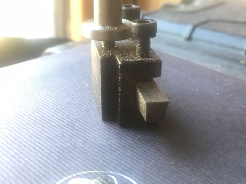

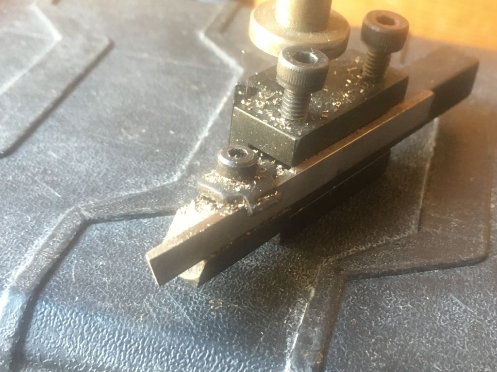

I wanted to cut a recessed groove into the brass. say 5mm deep by 5mm wide, so thought I would use a parting tool see photo below
I started getting a lot of chatter and unsatisfactory results so reduced the speed and gave a slight hone, which didn't help a great deal...
I also tried this cutter, since it was thicker...
not entirely sure the actual purpose of this cutter but since it had a flat top and right angle sides, I assumed it might be up to the job, alas I was wrong.
Any ideas where I could be going wrong?

It's not the best photo but the 1.5mm blade does look a bit blunt to me. You should have no problem with one of those even on the smaller lathes an an easy material like brass. Slide the blade back into the holder a bit more to reduce the distance from the tool post as much as possible.
The wider tool will put quite a load on the Cowells so I would expect some chatter from that.

On enlarging the pic it looks as though the 1.5 mm blade is dull / has a radius on the cutting edge which is where I assume you mean ...​'
...'gave a slight hone, which didn't help a great deal'...
​It needs to be really sharp on the tip otherwise you are 'rubbing' rather than cutting. I assume that you have the tip dead on centre height ( no insult intended ) otherwise you will be 'rubbing' just under the tip if the tool height is high, conversely if the tool height is 'low' then the tool will be 'dragged under' as the work tries to climb over the tool tip... broken tool / work / both.

I think you've got too much protrusion on your parting tool in pic 1.
The game is usually to set it accurately to centre height, minimum tool protrusion to reach depth or cut the piece off, as close to the chuck as you can get away with, about half nominal surface speed for starting, a sharp tool kept well into the job and maybe a spot of oil.

That smaller parting tool actually has a side rake angle, Does it need that? or can I grind it off? I only ask because when I tried to make the groove I could get a square edge on one side (left) then the other (right side) was obviously tapered because of that rake ground in the tool.
Emgee04/08/2018 20:48:54
2610 forum posts
312 photos
Steve, best not to have any angle on the front when grooving, even if parting if excessive it can cause the blade to cut towards the point giving a concave/convex cut.

I would blame the parting tool holder, with that overhang there looks nothing much to stop the cutting edge pivoting on the front and lifting the back edge as the clamp looks very flimsy.

I agree with Jason, the tool looks blunt, in fact the cutting edge looks rounded. You are no stoning the cutting edge by mistake by any chance?
Sherlock05/08/2018 02:01:26
52 forum posts
11 photos
I was trying to just hone the front face, but there is definitely a good chance I did a bad job it was slightly tricky for me trying to maintain the compound bevel angle that was ground on it with such a narrow edge.

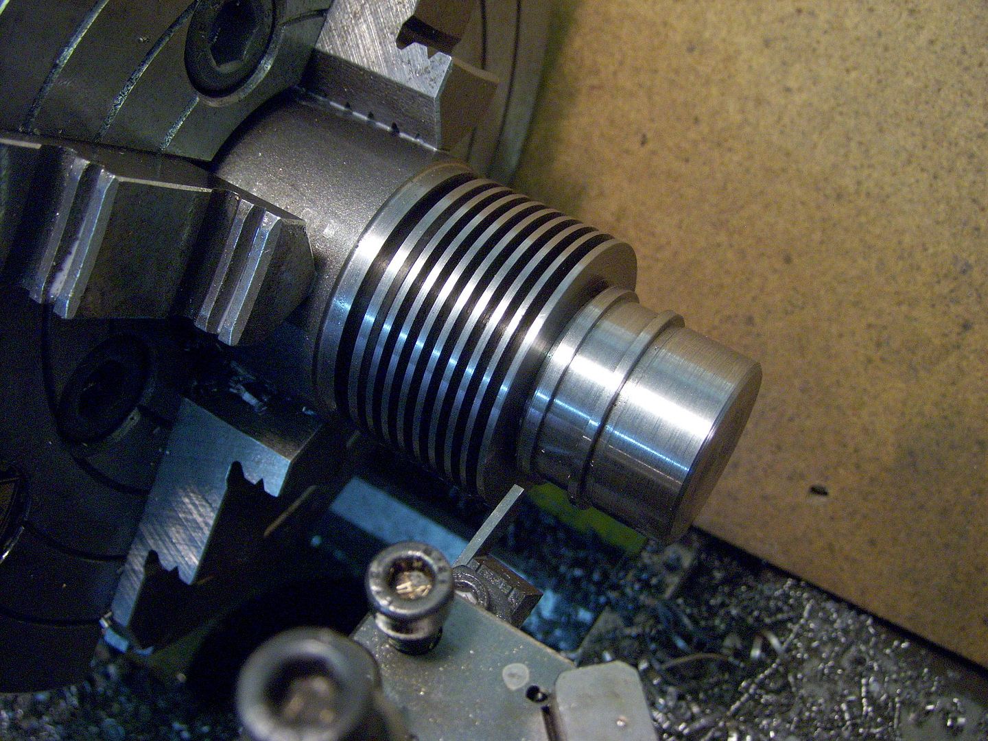

As the others have said grind the end straight across which will also help prevent it wandering sideways, make your groove with a plunge cut at each end to define the width almost to depth, plunge out the waste in teh middle also almost to depth then move the tool from side to side feeding in a thou or two at a time.
Same tool but a bit of 40mm EN1A did all thos efin grooves and the recess in one go no sharpening between cuts.

installed the new ground tool in the holder and readjusted to shorten the protrusion as suggested nipped up the small clamp on the parting holder only slightly and the chuffing allen head broke off. Only spare bolts I have don't fit can't quite work out the size and pitch.. appears to be 3mm x 1mm pitch but the head itself was an imperial size, so either way I'm out of action until I can figure out the size and source a spare bolt or a better parting tool holder, since someone mentioned that model doesn't look too great.
