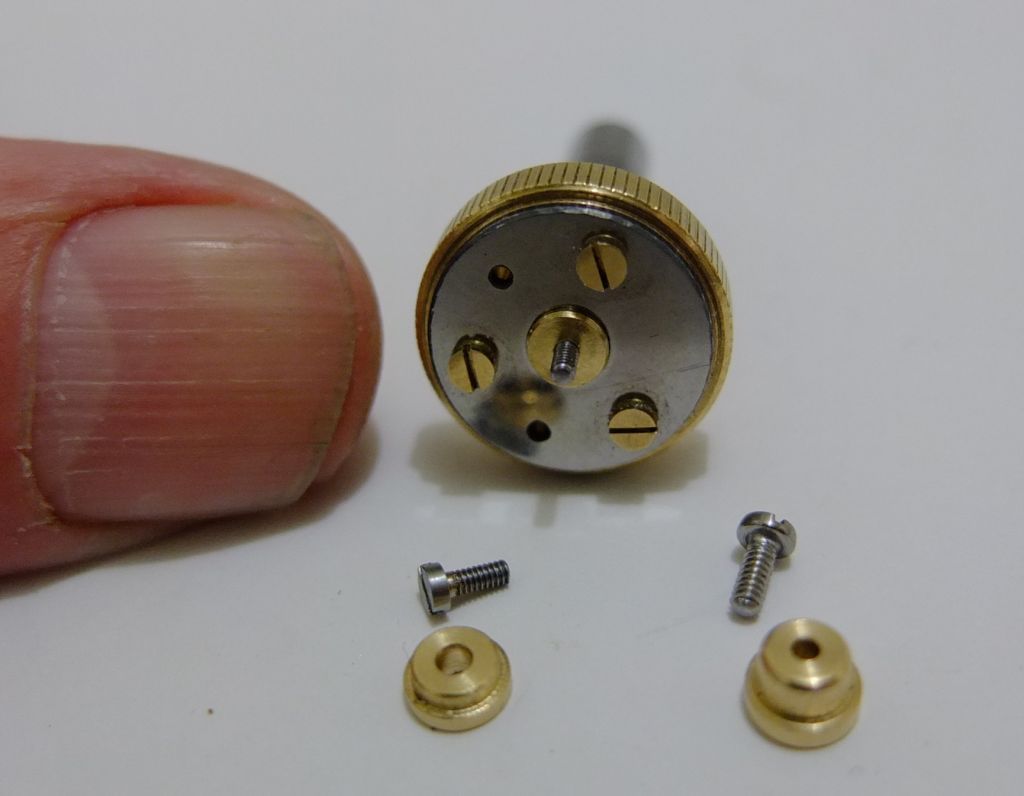

Steve Crow15/03/2018 13:40:08
429 forum posts
268 photos
I made a primitive lantern chuck for small screws. The collets are for 12BA and M1.6.
