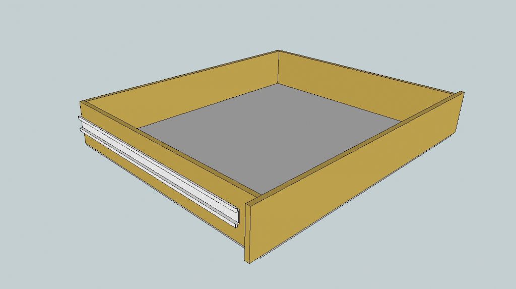

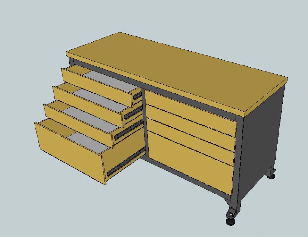

Hello, I'm at a loss trying to figure out the best way to construct drawers for a workbench and two machine stands. Basically I want three shallowish drawers at the top (10cm deep) and a single deeper drawer (23cm deep). I'm no carpenter so I have no idea how to go about doing them. My thoughts were plywood sides, fronts and backs on telescoping rails and a steel or aluminium bottom, ( if I went for plywood bottom I'd loose more space because of the thickness)... am I on the right track? Ideas and advice are most welcome.
This is what I have in mind, to explain myself better.

MDF is easy to use - 18mm MDF for sides screwed + glued base with extendible runners (eg from Screwfix) will take considerable weight (eg my granite surface plate sits in one such drawer - make a small jig (as used in making picture frames) to keep corners square - careful measurement or use a sawbench with guides. Often the larger B+Q branches will sell MDF offcuts suitable for sides at 50p or so (or even give it away ) just cut all drawer sides at same saw settings to guarantee easy square frames - consider use of the various plastic box inserts sold for the 'really useful' range of boxes

These ones are 18mm FE plywood sides glued and biscuited with a rebate cut in the bottom and 6mm MDF bottom screwed and glued in place on full extension runners.
These ones are a mix of ply and MDF sides as I was using up offcuts, again 6mm bottoms screwed on but no rebate.

you use floor varnish on the MDF once the drawers are complete - two coats will give excellent protection from oil + water - MDF is also dimensionally stable whereas natural wood needs allowance to be made for changes due to moisture + temperature

We posted at the same time. Not all MDF is soft and prone to swell. I almost only use MR (Moisture resistant) MDF for work, not only will this resist reasonable short term wetting and not be affected by humidity it is about 50% denser than Standard grade MDF and even more so than DIY shed MDF.
As with all MDF boards be careful when screwing into the edge, pilot drill and use suitable carcase or MDF screws.
As Frances says a waterbased floor varnish is easy to apply and hardwearing, having said that none of my draw sides are sealed. The lathe draws have 6mm Melamine faced MDF but the blue ones are just bare MRMDF.

one thing to note with telescopic slides is the accuracy needed in drawers + carcase - you need accurate right angles etc so use jigs + sawbench fences etc if possible.
One dodge is to produce the basic drawer with an attached decorate front but to initially cut a single piece of MDF that covers the full front for all drawers - drill out the holes for the bolts to hold handles easy to align these vertically then attach the full front to the bottom drawer using screws thro these bolt holes then pull out drawer + base + fix each drawer to full panel using prepared holes from inside the drawer - work up the drawers in turn - then unscrew all drawers from front panel, take panel to sawbench and slice each drawer front off the panel - add an extra curf cut(typically 1.5 - 2mm) at bottom of bottom panel to allow clearance - now attach all handles to fronts having counterdrilled holes at rear to allow machine screw heads to be flush (most handle fittings are 5mm thread and you may need to cut down supplied screws to fit + also add a washer) now just attach fronts to each drawer using the created screw holes - bingo all drawer fronts line up vertically + horizontally with just enough clearance

For workshop purposes you should always use full extension, full load, runners so the whole of the drawer is directly accessible. Many of the kitchen drawer kits are only partial extension so you need to fiddle stuff at the back out past what's in front or even partially unload the drawer first. That gets old real fast. Even those with full extension runners may not have full load capacity at full extension. Need to distribute things to keep the weight towards the back. Specifications also assume the load is evenly distributed. Plonking a small rotary table or decent size chuck in the front corner many be more than the structure or runners can cope with.
If you plan to store larger, heavier items such as chucks, faceplates rotary tables or vices et al consider making the relevant drawers open side with only a minimal lip for the runners. Easier to get a good grip without the sides in the way. Less lift needed to clear the sides too which can also help handling. Often worth packing up the bottom so as to give a straight slide off with no lift. Pretty much mandatory to do this with the common horizontal / vertical rotary table as the handle and dial assembly projects below the base so you either have to lift the base or cut a slot. Slot is not a good idea in practice! Tried it and rapidly re-engieered to pack up the base.
If one side of the cabinet is going to be up against a wall carefully consider what is going in that last bay as loading and unloading will have to be done semi-sideways with no elbow room on the wall side. Good place for sideless drawers or plates of holes for things like drill chucks, collets, et al.
