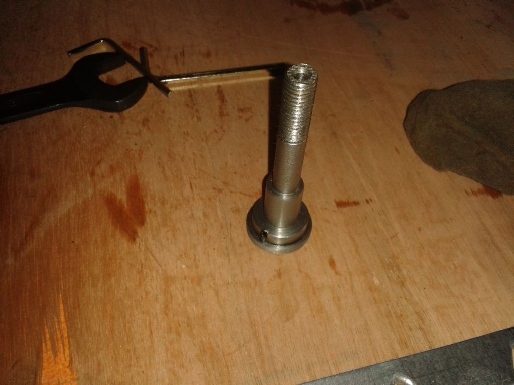

ChrisB11/05/2017 14:31:43
671 forum posts
212 photos
Thanks John and Jason, that was very helpful...so I took off the top slide (the pics came handy) and tapped the stud out, but it's not exactly as in the last pic. It came off with the boss and all and left a large hole. It's like a three stepped stud.
Will get some pic to explain myself better

Journeyman11/05/2017 14:39:46
avatar
1257 forum posts
264 photos
That sounds promising if all you have left is a hole and a flat top to the top-slide, sounds like all you need to do is make a new stud to fit both the top-slide and the tool-post that you choosesmiley
ChrisB11/05/2017 16:58:30
671 forum posts
212 photos
This is what it looks like. So I guess it should be relatively easy to fit the tool-post. Probably will go for this **LINK**

Journeyman11/05/2017 17:09:30
avatar
1257 forum posts
264 photos
I think you might need the larger model 100 version, check centre heights and maximum tool size etc. I have the model 100 on my WM 250 and your lathe is a bit bigger than mine. Also consider not getting the set, not all the tool holders are useful. Better just to buy the post and a load of standard holders. Ketan might do you a deal!
