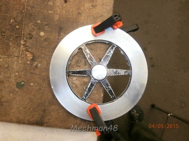

Interesting info guys, I used a piercing saw for a flywheel, 3mm x 150mm aluminium, for one of my models, thought of getting a scroll saw but couldn't justify the expense at the time, reading you comments... still debateable ?... oddly enough was looking at the Chinese models in MMart last week ... vat free day offer...?
​Cutting out flywheel with piercing saw, tedious, & a couple of broken blades along the way, told me... slowly, slowly catchee monkey..

roy entwistle11/04/2017 09:07:07
1716 forum posts
George. If you used a piercing saw on the flywheel as shown in the above photo, can I suggest that you don't clamp it down whilst doing it
Roy
mechman4811/04/2017 09:23:29
avatar
2947 forum posts
468 photos
G.Posted by roy entwistle on 11/04/2017 09:07:07:
Roy
Ta! noted for future ref.
