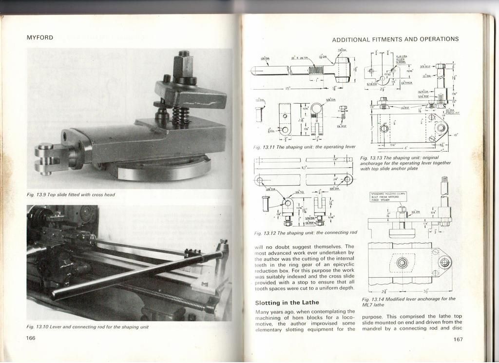

Going through an old cupboard, I found a rusty heap of change wheels. It is an odd collection as nowheel has the number of teeth on it, but for example 9-10 mm.
They are the same tooth size as Myfords and also thickness ties up. The bore is considerably smaller than the Myford bore.
I was thinking of boring them to Myford size and using them. The only snag is the keyway. How do you do this with the limited range of tools that I have at present. Basically an ML10 and most of the attachments for an ML7. I can think of ways to do the job but not with the kit I have available.
I did come across a slotting device which can be made (this one for an ML7). However I have no idea where I saw it. Can anyone help? I wouldn't mind making one up, I do miss my big power shaper!

Ian Bradley's book has several ideas but perhaps the most useful is based around the topslide without the feedscrew. The topslide is operated by a long lever...

Thanks everyone for your help, Why is it that I can't think of even the simple answers like the drilled hole, bore and then use a swiss file on the half moon left? I fear that I don't have the muscles left to do a lot of filing!
Simon, many thanks for your kind offer, I live in Rutland so I fear it would be a postal job! I would prefer to make up a slotting tool , because A/ it will expand my number of tools and B/ it will give me much needed experience as a retread.
So it looks like a toss up between the Ian Bradley slotter and that from Mikes Workshop, oh and the College Engineering casting set.
Which of the many Ian Bradley books is this described in? I have a few of them and maybe this is where I saw the design.

It works, but is slow. I think if I were doing a full set of change wheels, I'd look at making one of the simple slotting attachments. Maybe one as suggested I think by LH Sparey that uses a long lever pivoted on the rear tool post, and attached to the main tool post, with the topslide leadscrew removed.  But if you do one or two gears a day for a week or two, you will get there the slow way.
