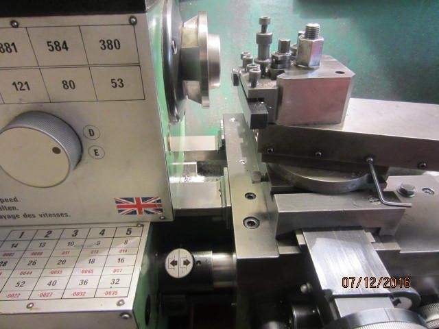

MichaelR08/12/2016 09:36:42
avatar
528 forum posts
79 photos
Posted by John Stevenson on 06/12/2016 22:40:38:
Problem is most lathes today have their design history well back. As an example the Series 7 Myford's all date back to 1947, a time span of 69 years.
Even the larger generic 12 x 36 and 14 x 40 Chinese lathes were roughly modeled on the Harrison M300 series which came out in about 1970
All of these were designed before guards came in and consequently none of them made room for a spring guard.
As John says if the lathe is designed for a spring guard there should be no restriction at the head stock, as my Myford 254s shows, I have had this lathe from new and the spring guard has not given any trouble.
