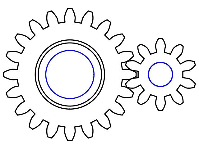

20-10 tooth gearsI use "Geardxf" from Forestmoon software to generate dxf files of involute gear forms. It's free and you can choose DP or mod. All the other perameters are selectable, too. Recommended.

John - GearDXF downloaded. A strange mix of software there - piano chords, CNC and a robot combat timer!
