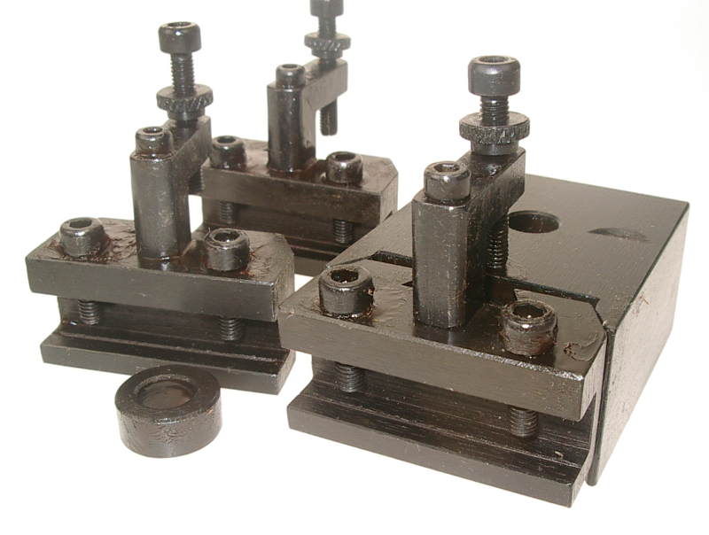

HI, All.
My minilathe has a standard toolpost and I keep each tool with some shims that pack it up to centre height. Changing tools is a bit of a chore but it's not terrible.
Simon of SPG Tools from whom I bought the lathe was against quick change tool posts because of the reduction in rigidity.
What actually bothers me about the setup I have now is as much getting the tool at the correct angle to the work piece as the time it takes to set it up.
So I'm thinking about a QCTP (as I believe we acolytes of the mysteries are to call it).
Firstly, do you agree with Simon - is rigidity an issue. Secondly, do I go for the eBay type (30 quid) or the UK Provided type (£60)?
The eBay ones seem to offer two mounting points and a cam based locking mechanism (where the tool is pushed out against the dovetail). It also appears from the photos that the toolpost proper is made of aluminium rather than steel which, frankly, concerns me (mass and flexibility).
The ones by our beloved professional UK suppliers (yes, you know who you are!) are all steel, have one mounting point and use a mechanism which draws the tool in, possibly being more rigid accordingly.
Will I get cross with my £30 purchase and need to go out one at twice the price almost straight away?
Thanks all!
Iain
Hollowpoint05/03/2016 10:47:16
550 forum posts
77 photos
Think you answered your own question, go with the steel one. For the reasons you mentioned it should be more rigid all round.
Not with mine (on a mini lathe).

Considering said mini lathe assume its this type
If so I would strongly recommend not to buy something else.
Rigidity non existent even worse the height adjuster being non repeatable the casting and screws flex.
In general all the other types massively superior and not from monkey metal.

So the recommendation so far is 'spend more money'. Gah!
I've found 4 mechanisms so far.
Neil's, which pushes a barrel out to push the holder against the dovetail.
One which appears to have two dovetails one to pull the holder in and one to be pulled against. I think the one JOn hates is of this type. Arceurotrade have one of this sort (which is not to say, that theirs is non-rigid, etc...). I think this is also how the 'Bison' type work link
One which has a moving outer dovetail that pushes in to secure the toolholder, such as this one from Chronos link
One which has a moving inner dovetail that pushes out to secure the holder. ArcEurotrade have this sort ​too
MY own guess is that the ones which pull in (the latter two) would be the most rigid in that they should have more direct metal to metal contact.
At £60+ quid I will have to save up (or add Neil's design to my long list of tools to build)...
