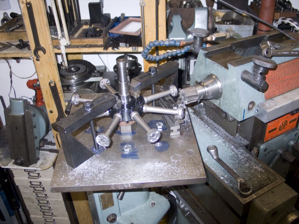

Phil P15/10/2015 13:02:43
851 forum posts
206 photos
I use this one for big jobs on the milling machine.
It is set up for work on the Pollit & Wigzell flywheel at the moment.
Phil
