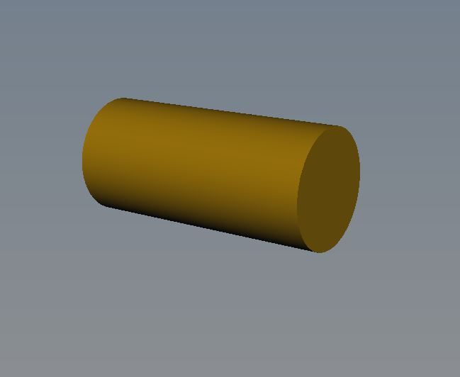

Thomas,
Having no text; your post is rather cryptic.
However; looking at your first picture, I would say that your parting tool is probably wrongly shaped, and not sharp.
Please let us have some more detail, so that folks here can advise.

As MG says looks like your tool is being deflected by the cutting tip angle. Or could be the tool is not set truly at 90 degrees to the workpiece.

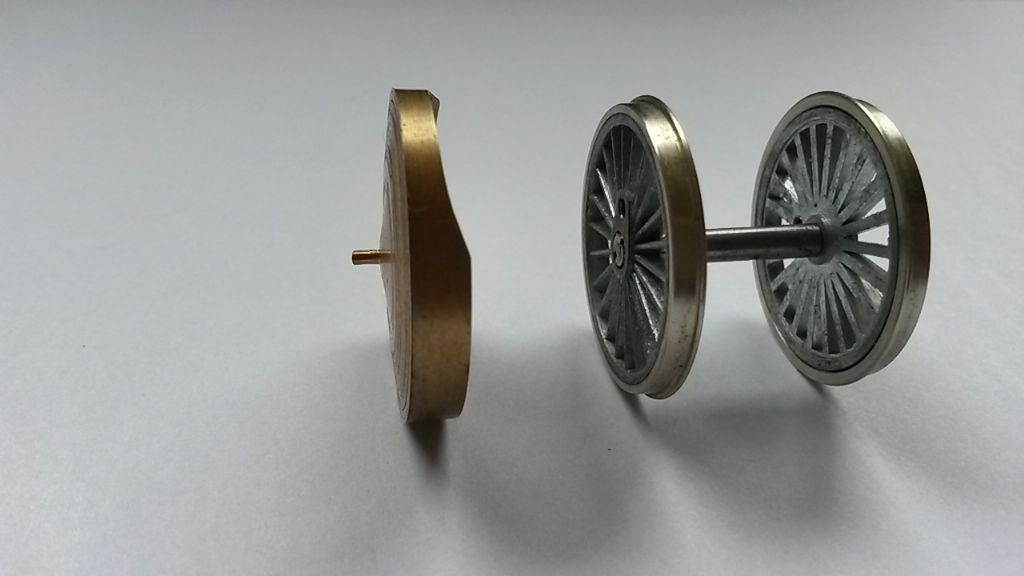

I suspect it's a demo of how to get an elliptical curve in some part for a loco and that it has been parted off in a way that allows the front to be domed later.
Pity about the stub left because it broke off before being fully parted off - usually because the feed was too fast and is why I generally feed by hand. Using the narrowest available parting off blade helps too but in this case some size of pip breaking off is likely but this one looks a bit big. This area makes me wonder why 1/2in x 1/16in blades seem to have disappeared off the market.

As Emgee says your parting blade is probably not quite square to the lathes axis or is blunter on the right hand corner. Judging by the pip that is left the tool is ground straight across so that is unlikely to be the reason for deflection as an angled cutting edge can throw the tool off line.

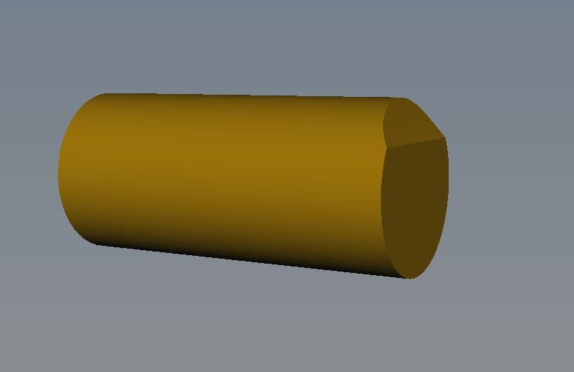

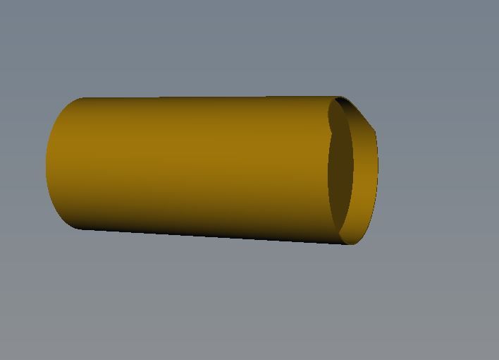

Just thought it may not be the blade that is deflecting, the part could be quite thin and being pushed away from the cut, you can get this when cutting things like thin cooling fins on engine cylinders.
If the "Disc" is as thin as the sides shown on the sketch then quite likely. Maybe we will never know.
If that is the case then turn up a plug to go in the recess with a ctr drill hole and use that to support the work with tailstock pressure until the cut is almost complete then remove while you cut teh last bit

I'm curious to find out what it is. Obviously it fits over the tyre, but why? And why the carefully made cut-out?

Ian,
The second image in the original post [note: I suspect they are presented in inverse order] appears to show a piece of bar, with a recess in the end ... immediately prior to the parting-off operation.
