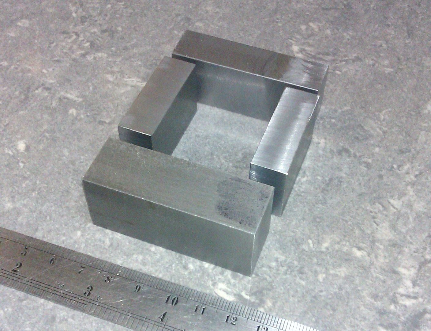

Andrew Johnston14/06/2015 10:28:45
avatar
7061 forum posts
719 photos
I couldn't give a ****** if people laugh at me, smile, so here's a picture of the parts I did/was trying to silver solder:
I have the small set of vermiculite blocks sold by Cup Alloys for a hearth. The SIevert burner is 2941, about 7.7kW, as that is what came with my torch kit.

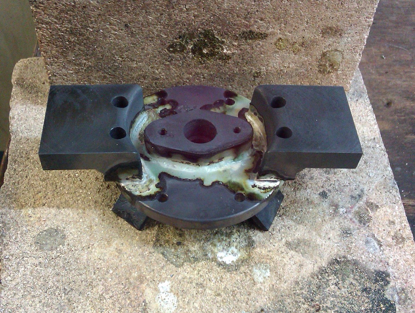

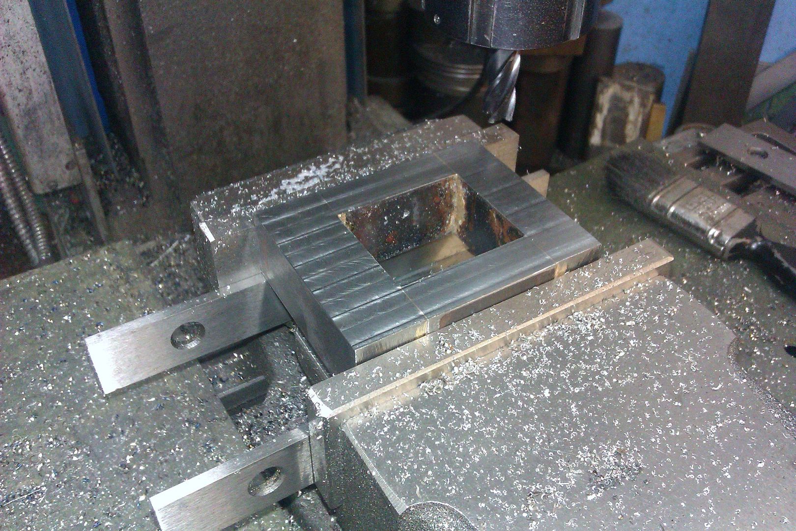

JasonB14/06/2015 13:24:44
avatar
25215 forum posts
3105 photos
1 articles
Your torch should be upto it, mine is a bit smaller and will do large steel though it does take a while to get it upto temp. These bits are 1"x1" at teh bottom, 1x5/8 ate the sides and 1x3/4 at teh top and done with on a similar hearth.
As you can just see the solder has flowed through teh joint which was gapped with punch marks.
This is 3" dia and the two L shaped bits from 1.5"x0.75"
You didn't say what the flux is, I used Tenacity No5 for that.
One other thought have you got the propane regulator turned up, you want 2 bar min 4 bar better.
For your levers I would have fluxed it all up and started by working on the round boss at the end, once the solder had flowed on that I would move along to the bosses around the slots. Could be done as two separate heats but as the round boss will have put some heat into the bar you may as well use that and carry straight onto the second.
