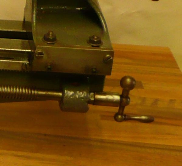

Hi everyone. I am new to the forum and to owning a lath .i have recently purchased a Myford ml4 . My question is how do you fit a lead screw handle there doesn't seem to be much room on the right hand end of the lead screw only enough for the nut. My history , I did a 5 year indentured apprenticeship as a press tool maker 1966-1971 two years after that I left the industry and never touched a lathe again until three days ago, so am quite rusty. Help would be appreciated
Here's a photo of an original Myford leadscrew handle, which was available as an extra. The leadscrew normally had a pair of nuts at the end. The handle has a threaded barrel and simply replaces the outboard nut. There is no scale or graduation, as normal for the earlier ML4.
