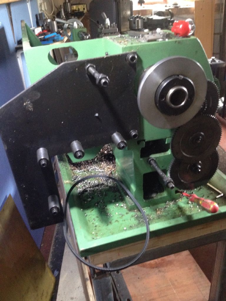

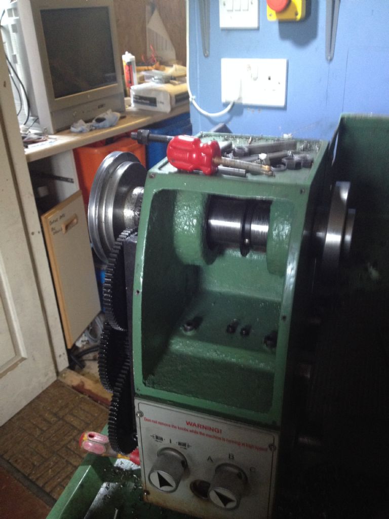

006.jpgI've had my wm250 for over 4 years now and I've been happy with it other than the variable speed.Its hand being able to turn the speed up and down whilst on the move but the torque is pretty poor at low speeds.The motor soon gets hot with a low fan speed and you have to keep stopping when it starts to smell that unmistakable smell.
I decided to splash out £100 and get a qctp from rdg.Beautiful bit of kit,but of course it needs slight modification. Following the way its done on this link http://www.cign.org/wm250qctp2.html I had to turn a short 84mm plinth for the post to stand on. All I had was a piece of about 4" so I started turning that down. What a joke could only put on 0.5 mm cut on the dial,that's 0.25 mm deep cut. The lathe would stall on anything less than 150 rpm so next thing I know the rcd tripped. My old Myford,as worn as it was would have made short work of it in backgear. Don't know if I got a bad machine or what. Is anyone getting any better performance ??
what iv'e decided to do is go 3 phase with inverter as per my milling machine. Started stripping the dc stuff out.
Went on ebay this morning looking for a suitable motor and inverter and after a couple of clicks my pp account suffered to the tune of nearly £300, but worth it I hope. 005.jpg
Rik Shaw28/02/2014 14:30:47
avatar
1494 forum posts
403 photos
Hello John
Results from my wm250-vf a few minutes ago:
I chucked a piece of unidentifiable 60mm dia. bar. It was not mild steel - something quite a bit tougher.
Set the speed controller to 126 r.p.m and using a tipped tool applied a 1mm cut (2mm of dia.). Set auto feed going and turned down the OD of the bar a short distance. The machine struggled/faltered but did OK.
Changed the tool to a tangential holder - the tool bit still a little blunt from a previous job - and repeated the above. This time the tool cut much easier and with no speed judder as with the tipped tool. The only thing I noted was that the second cut with the tangential slowed the speed from 126 down to 106.
I don't think I'd like to go any deeper than 1mm using the above scenario.
I'll leave you to draw your own conclusions.
If you need any more help comparison wise just shout although it looks like you have the matter in hand with the new motor.
Rik
john kennedy 128/02/2014 14:48:23
avatar
214 forum posts
24 photos
Thanks Rik, Yes a lot better than mine was doing I think. Anyway I've gone past the point of no return now so fingers crossed the motor will squeeze in. I'll keep the gear ratio low, about 700 to 800 rpm at 50 htz so there will be plenty of grunt low down. In 4 years I've never felt the need to go into the 1000 to 2000 speed range. I'll put some more pictures up when the goodies arrive. John
