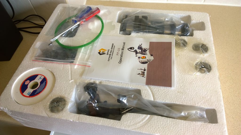

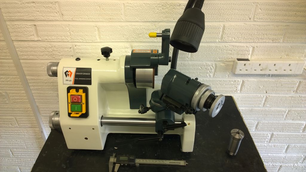

I think quality wise its much better than a lot of the other especially those seen on ebay and youtube, the fit and finish is much better than I was expecting, the tool holders fit on a dovetailed slide with gib strip, all three fit snug without any major adjustment of the gib, just slacked the lock screw. I wasn't expecting that. The lathe tool holder is a bit cheapo but the other accessories are well made and well finished, the paint and finish is much better than my lathe and milling machine
The only down side is the lack of instructions, but for me that is the interesting part, working out how to use and set it up. As an apprentice many years ago I spent a week or two messing about with a Clarkson which stood unloved in the corner of the machine shop. I got great satisfaction when some of the machinist started asking me to sharpen and dress some of their tooling (most just went to the stores for new due to the time required)
The best part for me is I now falling asleep thinking about using it ~ Not laying awake thinking about buying or making a Tool Cutter Grinder

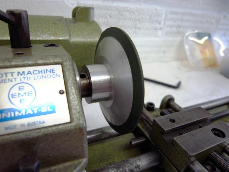

I did convert an Emco Unimat once over its OK just to dress up the ends of milling cutters but lack the rigidity ~ This thing is really solid ~ it's 50Kg

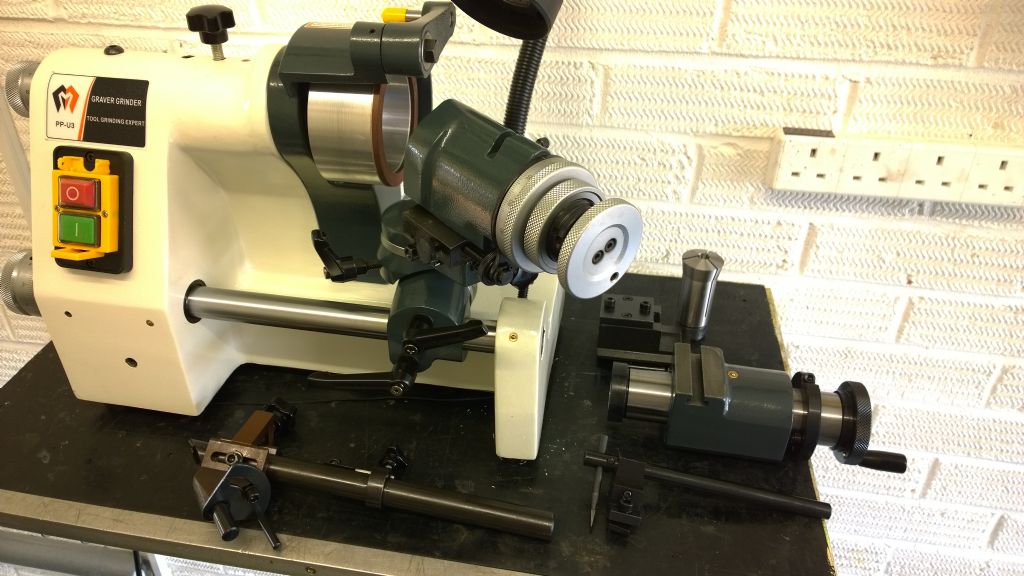

Got fed up of thinking should I buy a Universal Tool Cutter Grinder, yes I know there are loads of thoughts about this subject, yes I know you can buy loads of new drills, milling cutter, etc for the price. What the hell ~ I just went and got one after several years thinking about which to make or buy, make, model, size, where from and all that.
Well I just went and got this.....
Its from RDG Tools, well made, good fit and finish, everything is smooth and tight, I'm really impressed for the money and I'm going to enjoy fiddling in the shop with it ~ Yes I know some of the other are easier to use and are smaller, but you can only sharpen the ends of milling cutters. I really do love messing with machine tools and this will give me no end of fun playing with it.
The quality is much better than the photos on the web page show
Its from RDG Tools (check out the web page, its under new tools, scroll right down to the bottom of the page)
Will put up some more pictures, and don't hesitate to ask any questions ~ will do my best to answer, I'm no expert, just enjoy playing in the workshop

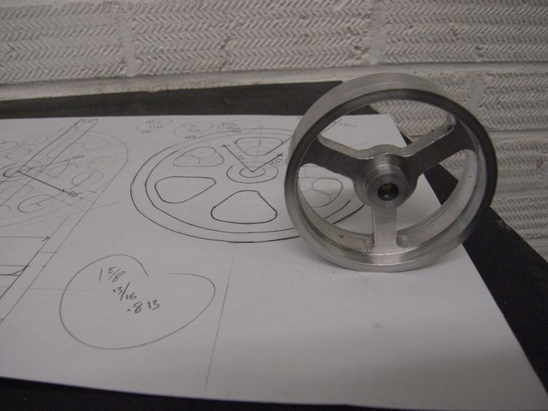

Turned the handle on my rotary table the wrong way ! Making a Fly Wheel for the OBG Beam, wanted 6 spokes but end up with 3! As soon as I moved the handle I knew I'd gone wrong ~ Could of made the spokes thinner but as it was my first attempt used it as practice, and knew I needed to made it in brass Ali fly wheelGuess who turn handle wrong way and ended up with 3 spokes !Re made in brassBrass Flywheel fitted Much better

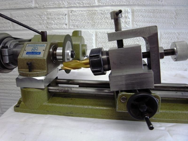

So the bottom draw in the workshop has a few milling cutters which are a bit dull and have lost their edge. Always wanted a ToolCutter Grinder and one day I'm sure I'll make a Quorn, Stent, Worden or go and buy one. Up until now I've always though about the cost of a Tool Cutter Grinder Vs the price of a new cutter. Looking at the growing pile of blunt and chipped cutters there are a few that only require the edge "touching up" so heres my solution, yes it needs a guard and few other mods but I just made it to see if the results were OK. The only real problem is I can only sharpen the ends of Slot drills and End mills and not the sides and the diamond disk is turning down across the cutting edge rather than away from the cutting edge, but it hardly leaves a burr block1 resized.jpgthe block milled with a 6degree and 8degree angle and two mounting holes square to theses facesblock2 resized.jpgsquared up an off cut of angle iron a mounted it central to the 3mm deep slotblockscrews resized.jpgadded a stop screw and clamping bolt12mmcarrier resized.jpgmachined a carrier stub with 12mm x 1mm pitch threadmc12mm resized.jpgscrewed to Unimat SL nose and machined in-situ to take the Diamond Grinding Wheeldisc resized.jpgDiamond wheel runs true as stub cut in postiondiscutter resized.jpgMade a Riser Block to fit under the headstock of the lathe - this has to be 20mm thick so the Unimat Headstock clamp worksaligncutter resized.jpgMilling cutter aligned horizontal with vernier on surface plate so as each cutting edge is sharpened in turn the are square and the stop screw ensures correct depth of cutunimattoolcutter resized.jpgsmall light cuts feeding the cross slide. E25 Collet Block ensures correct alignmentsharpcutter resized.jpg
