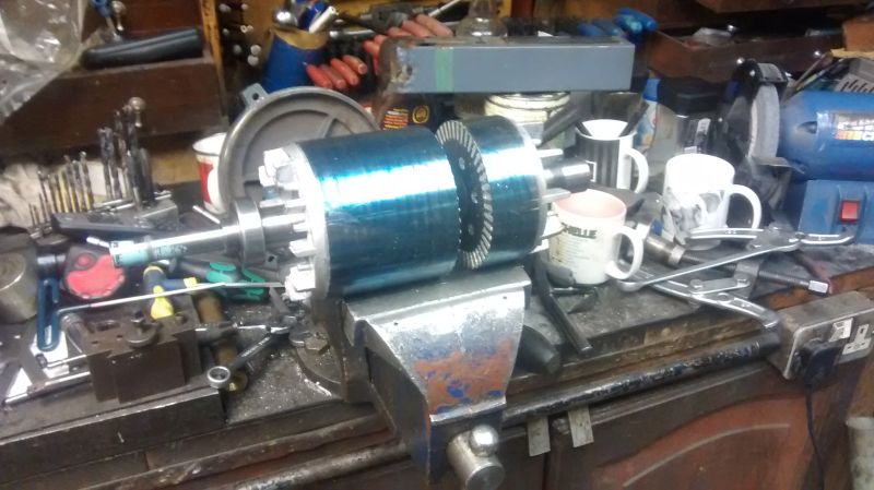

Not sure if this is going to work ??
Got a tall 3HP motor her thats too tall and also a bit to powerful, so thought I'd try this and see if it works.
Carefully cut it into 1/3rd - 2/3rds, just need a new shaft now.
Reckon it will work ?
Les Jones 121/11/2014 22:41:38
2292 forum posts
159 photos
Hi John,
You'll have to remove a few laminations to expose the ends of the copper or aluminium bars to allow you to short all the ends together. I think the fun bit will be rewinding the shortened stator sections. You should have saved this one until April 1st.

Hi John, should work, now I've fixed it for you. nerd
