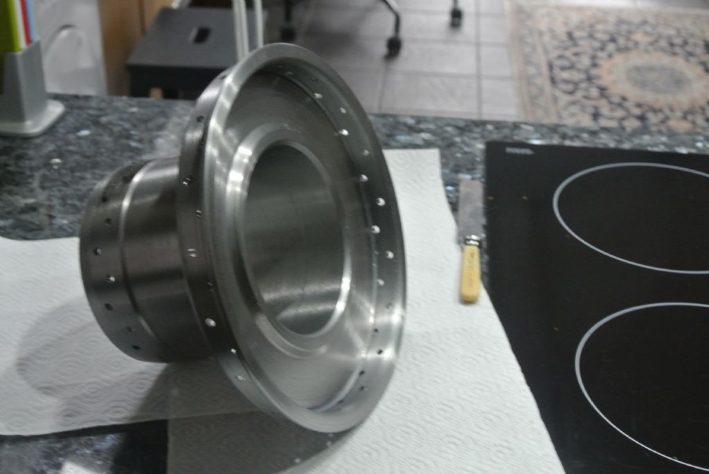

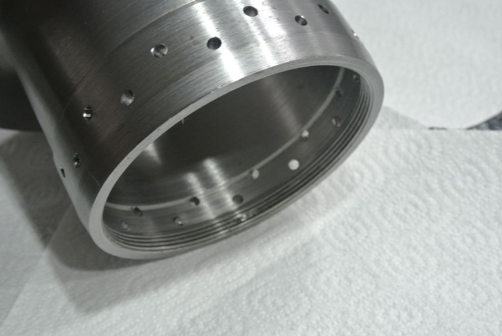

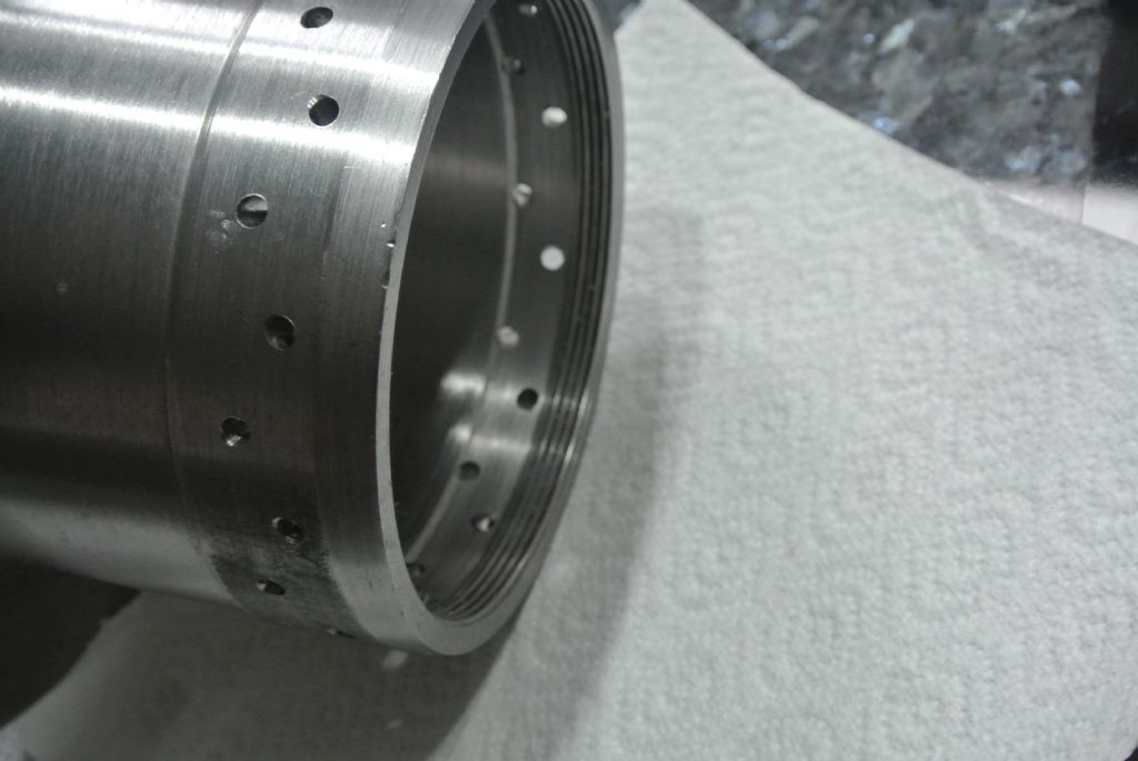

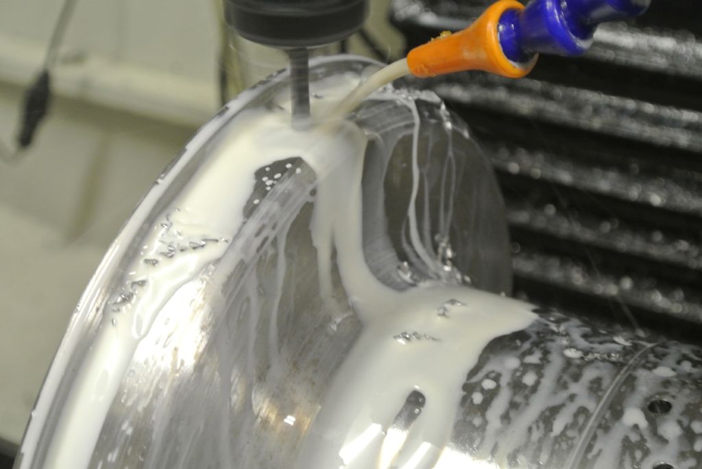

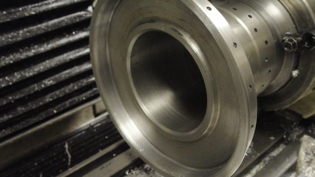

Today I finally got one of the batch of Wire Wheel Hubs I am drilling for somebody done after recovering from a nasty CNC crash. This was caused by me making a Freudian slip when I entered a Z value in my g-code as 48 instead of 84. I could see that the spindle was going to hit the work if I didn't stop it but I had the camera ready to take a picture and by the time I put it down it was too late.
The spindle contacted the work, snapped the drill, rotated the threaded hub anti clockwise and while it was doing this it pushed the adjustable angle plate out of alignment and ground the ER collet nut up a bit. The hub seized on the thread and took a lot of effort to get it off the faceplate fixture. I had to take the fixture off the rotary table, put it in the lathe 4 jaw chuck, fit the three jaw chuck on the small diameter and using metal bars and a 3foot long cheater bar on the end of one of them work the hub free. Much to my amazement there was relatively little damage to the threads on the fixture or the job and I was able to dress this with the Dremel. The outer diameter of the hub was badly marked and I had to re-machine this to get rid of the damage but I don't think this is critical so all in all a good recovery.
The job is not as straight forward as it looks because the spokes are drilled at an angle through the small end so the two rows of holes at that end are drilled separately with the angle plate set at 14 degrees then 13 degrees respectively. They are also drilled with an offset from the centre line. Getting the angles sorted out and drawing the hub was the biggest part of the job. I still have to countersink the holes which I will do as a separate programme but at least the main bit works.dsc_4078.jpg
The time between tool to metal contact and hitting the E-stop is the shortest period known to man; and is always positive. crying 2
Hooray for CNC I say. thumbs up
