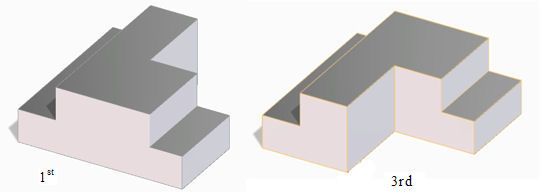

Terryd20/09/2012 14:26:00
avatar
1946 forum posts
179 photos
Hi Wolfie,
Better, and half right. (drawing skills no problem, as long as you can put over an idea accurately it is inconsequential). Actually that is one possibility, however if you gave that to an engineer he would either wonder what the line down the centre of the top represents or conclude that it is two seperate components.
These are the two possible solutions (there are others but more of that later) :-
If the drawing was in first angle proj. it would look like the example on the left (as you drew it, but rotated 180) the sketch on the right is what the component would look like in 3rd angle. Of course this is a simple example and would be explained with a plan view, but not all confusions are this simple and can lead to some real problems if the conventions are not understood and observed.
The cut out could also be curved (e.g. quadrant) and that would also need a plan. I have though seen drawings in ME which have confused me until I realised that one side view was in first angle projection and the other in third angle crook. It is useful to understand the differences and be able to interpret drawings correctly to prevent expensive errors
I was recently able to buy for pennies a rather nice piece of steel, about 20mm thick by 300mm wide and 450 mm long which had been accurately ground on both sides. The unfortunate machine operator had read the drawings wrongly (1st/3rd angle confusion) and made a very expensive piece of scrap - great for me, not so for him I believe.
It's not just a pedantic exercise, believe me, when some use 1st angle and others 3rd angle projection systems. It would be good if we could all agree on one system but its a bit like the metric v imperial debate, but let's not go there - its Tiger country! wink
Best regards
Terry
Edited By Terryd on 20/09/2012 14:27:57

Actually I've just noticed summat. If you rotate those two solids 180º they swap projections. I drew your left hand one but I thought it was 3rd angle cos the end view was on the right.

Putting it all as simply as possible:-
1st Angle Looking at the front elevation - What is seen from the left is projected over on the right.
What is seen from the right is projected on the left.
What is seen from above is projected below.
3rd Angle Looking at the front elevation- What is seen from the left is projected on the left.
What is seen from the right is projectied on the riight.
What is seen from above is projected above.
The spacing of views on the paper is first worked out and normally the FE is drawn, then one side elevation. By projection lines directly from these views, and via a 45 degree line, the plan view can be drawn without measurement.

3rd angle is only used America and Australia, the rest of the world uses 1st angle ortho - so not really that obvious, and not "as previously used in the UK" either - it really depends on your way of thinking.
The easiest way to understand the difference is by imagining that your "object" never leaves the page, - now this is a fairly lose analagy from my brain - for a proper insight, as I think previously linked see here - but you might get bored quick, even though the page contains less words than this post....... http://www3.ul.ie/~rynnet/orthographic_projection_fyp/webpages/third_angle.html
1st angle, the object sits ON TOP of the page, and so rolling to the left, displays the right side of the object (assuming its a cube or simple shape)
3rd angle, imagine the object is under the page, rolling it to the right, displays the right side.
now if you think about 3rd angle from a 1st angle persons perspective, you can see where it gets its name from, as from a 1st angle persons way of working, you'd have to rotate the part 3 times to get an adjacent view.
If you look back to the cups, it should make sense now, page under...... page over etc. =) - the iso view is for folk who can't read 1st & 3rd angle and don't know the difference between a hidden line and a normal line as 1st or 3rd angle - doesnt matter, same information, different arrangement on the page!
Sry I'm editing like a bugger ignore what I just said, imagine a drawing of a dice with a printed symbol on each face. Lines and fetures wont position each face so unless you knew if you where look at a 1st or 3rd angle, you couldn't possibly arrange the symbols correctly as the draughtsman intended (maybe its loaded..... or why would it matter lol, loose example)
