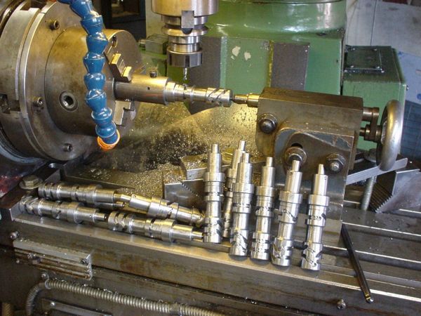

No not really you have to take it all into context on what you are doing. Whilst I'm a big believer in that CNC has a place in the home workshop it's not at the expense of all CNC
This week I have done 24 three HP electric motor conversions where the shaft has to be turned down and the keyway deepened plus making 24 steel conversion plates up out of 10mm thick laser blanks and guess what ? All done on manual machines you will find in the average larger workshop.
Now if I had just one of these to do.
Can you just imagine what tooling and jigs would be needed for a job like this ?
Six speed gearbox selector drums for racing motorcycles BTW, and less than 3 hours work.

John Stevenson19/06/2011 00:48:07
avatar
5068 forum posts
3 photos
Phil.
I think it all depends on how you look at the finished job. The closest I came to doing something like the above but manually was when I was racing and wanted some oil pump plungers for the old Pilgrim pumps.
These had one cam track on them that caused the plunger to oscillate backwards and forwards as it was driven.
Being very much pre CNC I scratched my head and came up with a swash plate follower that was literally a large disk welded on an angle to a shaft, a follower dog then pushed the new plunder over in a very crude 4th axis whilst I milled the groove.
For me even though it worked I resented the time taken to achieve this as my main interest was getting the bike running again, not how to get it running again. If I had have had access to CNC at this point in time I would have used it in a heartbeat as for me it was all about the reward, not the journey.
I don't regard it as dumbing down, in fact on those cams in the picture there is far more work in making sure all the dogs are in the correct point and space in time than actually doing the job. Some of the engagement dogs miss by 10 thou whilst shifting.
Although paid, I do regard it as a hobby as it's not my normal line of work and I find these sort of jobs interesting and only take them on if interested.
There are some very lucrative jobs in the vintage movement if you can spot them, especially where the owners have more money than sense.
John S.
