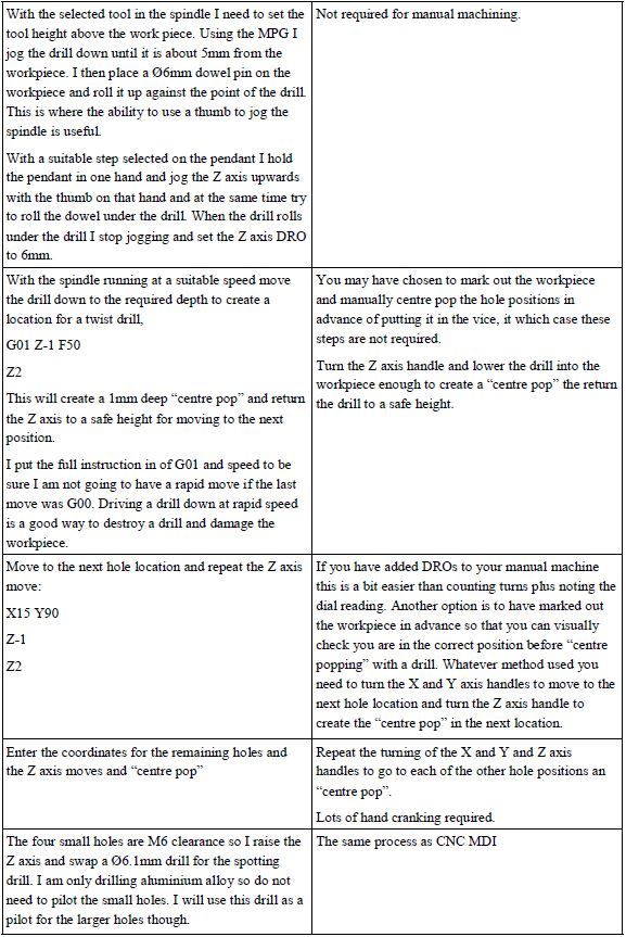

A short time ago I made a part using the manual data input (MDI) of Mach3 to do the work. I thought it would be interesting for all the manual machinists to look at the half-way house of CNC that is MDI so wrote up the process with a parallel commentary of what a manual process would entail for comparison. I think it would help some of the people who may be interested in dipping their toe into CNC but are daunted by talk of 3D CAD and CAD/CAM/CNC with POST processing and all the other abbreviations that can be bandied about. It may also enlighten some of the people who think CNC is just pressing a button and sitting down to wait as to what may be entailed. Due to the limitations of this forum there may be some loss of quality in the prints.
