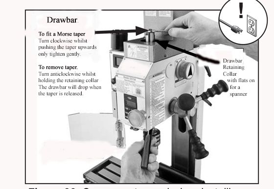

David Caunt24/01/2020 22:42:25
avatar
110 forum posts
40 photos
Hope this modified stolen pic shows how I got round the problem.
