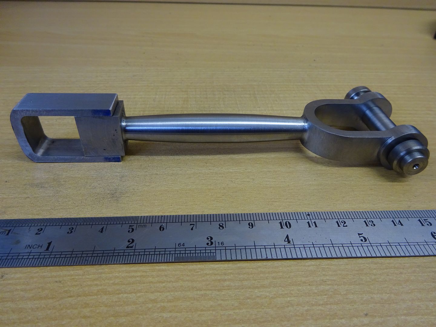

Over the weekend I have converted a piece of 0.75" x 1.5" EN3B into a pile of swarf and been left with this which looks like a conrod

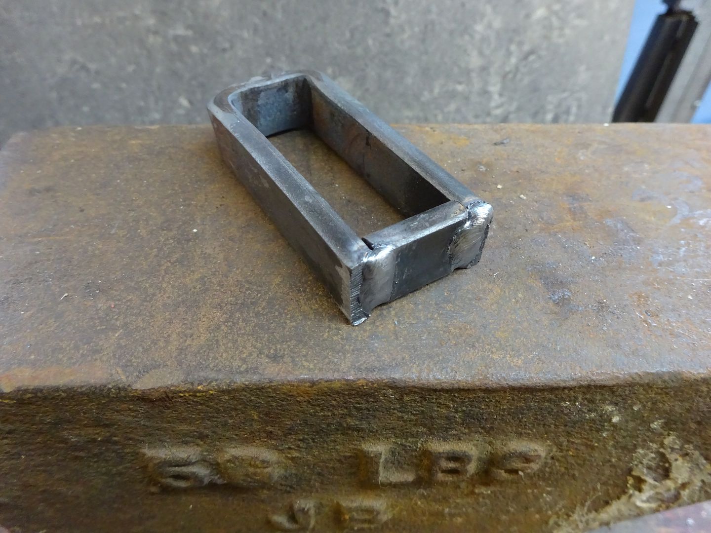

The strap was bent up from a bit of 4x15mm black bar, an offcut welded into the end to stop it closing up while in the vice so it could be final machined.
Still a bit more to do.

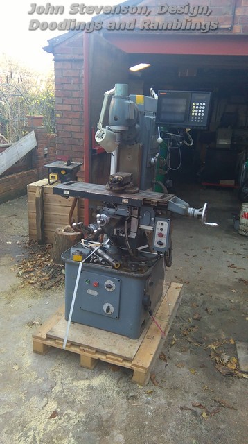

Funnily enough this landed on my yard this morning.
Pretty complete, has the arbors, vise, collet chuck with collets and a full set, I think ? of 8 pick off feed gears.
No manual and there isn't one on the Yahoo Harrison group. The Anilam DRO is playing up and I suspect the head.
No time to play with it at present so it's gone into winter storage.
