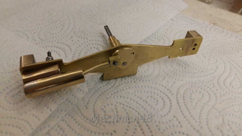

mechman4808/12/2018 10:48:51
avatar
2947 forum posts
468 photos
A bit more on my Boxer oscillator, trail assembly of 1 Cylinder, piston, back crank plate. Haven't touched it for some time, other stuff came to the fore... face 18. Not really over enamoured with the crank plates assembly as it stands at the mo'... there is alternative arrangement that can be used but will percy veer with this arrangement for now...
… and for the eagle eyed can you spot deliberate mistake ?
George.
