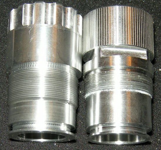

From memory if go to a better aluminium stock holders and get off the shelf hydraulic tube 1 1/4" x 3/16" it has a pressure rating of 70 bar region (1015psi) Subject to the end plugs being adequate that vessel then should not operate above 676 psi.
Heres an end plug on right M30X0.75 max 10 full threads and rated not at a comparitive puny1000psi but 300bar (4500psi)
This actual tube would not have been tested, maybe just a sample now and again with the prototype. It will however being German have date, max fill pressure, TP, and manufacturer etched. Like other vessels that have similar specs and passed same standards, i have seen many cracked tubes in fact got two here now both within the 10 year life span. Point is no matter how big a company is, they are not fallible.
Same company Prelutech in Germany notice 200 bar working pressure, test pressure 350 Bar
