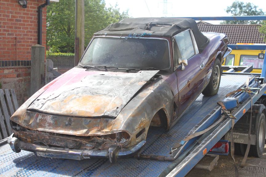

Actually Paul,
it was two Triumph Stags crying 2. I was just about to install a newly reconditioned engine into the 2nd beastie. It was just outside the garage door as you need a very high lift and at 9ft high not even my garage was high enough. If you look at the picture in my last posting, you can see a 24ft long beam with a pile of masonry. The Bradstone masonry was built on top of the beam in a style I like to think of as 'Fred Dibnah'. That fell on to the front of the car from a height of 9ft +. Here it is leaving It was pristine before the fire. The canvas roof was new, but bleached from the fire and torn where masonry had fallen through. Here goes (to the tune of 'She's Leaving Home' by the fab four):
Note the carbon inside the screen due to the fire travelling under the car and starting the carpets and upholstery to smoulder. The loss adjuster said there was no evidence of fire inside the vehicle.
It was thought to have been caused by an electrical fault, and it had been a very hot day

Terry that must be devastating is it salvageable?

No, the insurance company insisted it was removed as it had been involved in a fire. It is probably now containing dog food on supermarket shelves.
