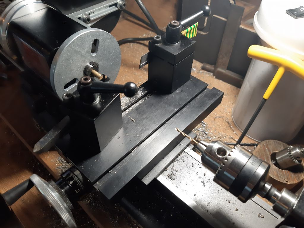

I'm ok, managing the heat, no problem but the Sherline is suffering.
Turning up some brass bushes with set up in the photo using the front and rear Toolpost.
With posts firmly locked in place the cross slide feed has gone very heavy.
Release the locks and it smooth and as normal.
Too hot, expanding aluminium alloy cross slide, can't take the heat, resulting in abnormal distortion? What do you guys think?

Sounds as if your toolposts rather than temperature are distorting the crosslide. I have the same problem with a long vice on the table of my D-W mill. When I grip a job in the vice the X slide movement goes stiff whatever the temperature. Not helped by the skinny vice base and the unusual tee slot arrangement of the mill - it reduces the longitudinal stiffness of the table compared to the conventional arrangement. If I'm after accuracy I mount the job on an angle plate using G clamps.
